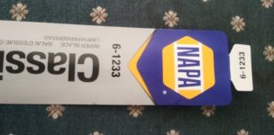

Nappa Part Number 6-1233. I just bought one this morning and it was easy to replace and fit perfectly on my 1999 cruiser with manual wipers.
Some earlier posts listed the part number as 60-1233 and when I went to Nappa, I was told that was the old part number and the number is 6-1233.

Just replaced wiper blades on our 99 22’ cruiser. NAPA Classic, 6-1233. Pleasant surprise... In stock, done deal. Ken
