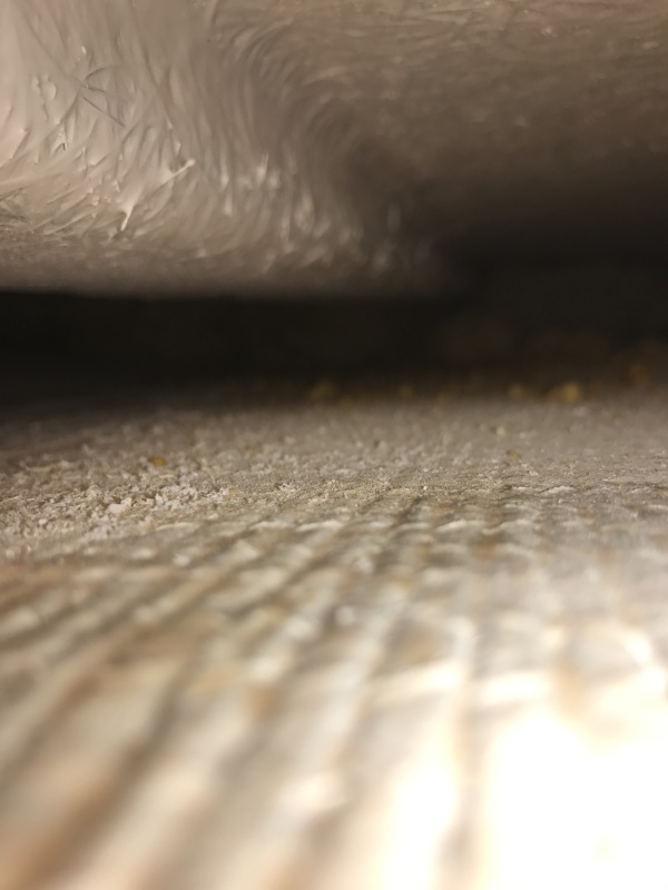

I have a 2007 Cape Cruiser Venture 23 and it has the support running fore and aft in the middle of the cockpit. The thread linked above is very helpful to this issue but can be a bit of a bear to get through.
If I remember correctly I think it was determined that Cape Cruiser started adding the support at about the same time it moved the water tank from the port side below the aft settee to the vee berth (i.e., if your tank is below the vee berth it is more likely you will have the support).
This photo isn't great but it at least shows the support:
