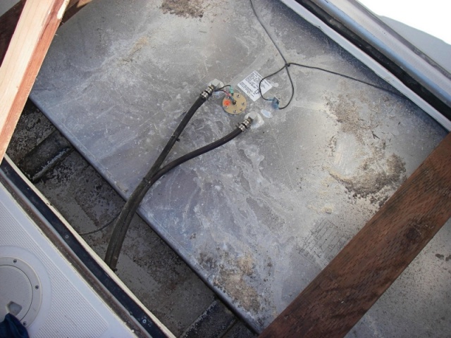

As mentioned by Avidmagnum12/Tom Schulke above, there's a direct connection/hole between the tank compartment and the rear bilge. Remember, Journey On is 12 years old, so the boat can survive, it's just built that way.
Here's a picture of the cockpit floor removed and looking at the tank:
It's not the clearest, but here's a few salient points. First, there's a direct connection between the center of the bilge and the tank compartment. Seek and ye shall find. It's built that way. Next, there's little or no connection (don't remember which) between the bilge and tank compartment at each internal skeg depressions, both port and starboard. I drilled new holes so the water can drain to the bilge even if the boat isn't level. When the boat is on the trailer and the front is tilted up, I drain and mop the bilge. More photos in Journey On Tank Inspection. Included is a shot of the floor with the steps removed, though they're not the main cause. Mopping out at the steps doesn't get rid of the water, because most of it is in the rear.
Water gets in when you wash your boat. A LOT of water drains down through the cockpit locker. Any time the cockpit floor is wet, more water drains in. So the first solution is to seal those cockpit lockers. Good luck, it can be done; I haven't. Also, put new o-ring seals in the removable hatches. I installed a hatch in the floor so I can be sure that the tank compartment is dry.
