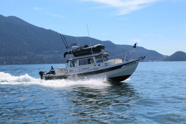

We indirectly "won" a tall radar arch at the old factory parties they used to host around the Seattle Boat Show way back in 2007. Long story short, Barry of C-Cakes won the radar arch but I was perceptive enough to realize he already had one installed on C-Cakes so I asked him about it and we made a very fair trade.
I installed the arch in the spring of 2007 and our Alaska Series dinghy fit under it perfectly like the two were mated to each other. The installation is not hard, it just was a little painful to drill the holes in the roof which happened to be cored on ours but other than that, easy breezy. Just be sure to slather enough bedding compound between the radar feet and the roof to prevent any leakage. I figured that out the hard way. Hope this helps.

Peter,
Thanks for the response and pictures. Just what I wanted to see.

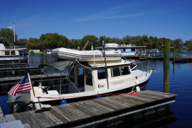

PostPosted: Sun Jul 30, 2017 11:34 am    Post subject: Radar arch vs fwd mount Reply with quote
Hi guys,
As some of you know my 23 venture package is being built at the moment. I did not opt for the radar arch at this point due to dollars spent already but am pondering the benefits. Here are my questions:
If I simply go with a forward radar flush (shimmed) mount on the cab "maybe" I can get the factory since they are building it and this boat comes with the dropped ceiling and vinyl to mount it for me (I'm visiting the factory Friday I could bring the stuff with me) the thought here would be that I would not need to take the ceiling down to install it after it arrives. Either way wether they are willing or not could I still mount a 8-9ft dingy with a forward radar?
As to the radar arch - doesn't the dingy interfere with the radar when mounted on the arch? it would based on angles seem like it would... i am not a fisherman other than occasional trolling, other than looking cool and sliding the dingy under the arch what additional benefit does it provide?
Last but not least if the inflatable dinghy doesn't interfere with the radar then it would seem I could have the nose of the dinghy above the radar too if flush mounted? I dunno just split balling here. This will be my first radar and thus do not know the details of how sensistive they are etc.
Any advice would be great. If I have to I can add the radar arch but need to know the dollars justify the benefit.
PS the radar I bought is the new quantum radar from raymarine. Not sure if it matters (never realized how large these things are)

PostPosted: Sun Jul 30, 2017 12:15 pm    Post subject: Reply with quote
The 23 is going to be slightly different than the 22. I have usually mounted by radar on a short pedestal. The dinghy is not a problem with the radar. If you have an aluminum plate where the dinghy motor clamps that is the only potential issue.
The high arch will allow the dinghy to slide under the arch, and gives a slightly better place to carry the dinghy.
We have had both radar and dinghies on all of our C Dorys. My son has a 10' dinghy on his 25 roof, along with radar. A picture of our current 22, with a 9'6" dinghy on top. I could have mounted the strut "reversed" or made a platform for it further forward, but with some over hand over the cockpit it works find (the inflatable is a high pressure air floor, which I consider to be the best compromise between weight, ease of assembly and stability/performance.
My strut has a rake aft, it could have been mounted so that the rake was forward. In this case the radar is above the dinghy, but I have had radar which were lower.
This radar has a 3* down slant wedge. However I have never mounted a radar flush on the cabin top on a C Dory.
The factory should be able to accommodate you---give them a call and find out. Possible that they could put the cable in with out the radar, but you would still have to pull the headliner to bolt the base or strut in place. I moved the anchor light to a fitting which attaches to the radar strut, and puts the anchor light above and aft of the radar. (The small tubing, or even a sailboat mast, does not interfere with the radar function.)
