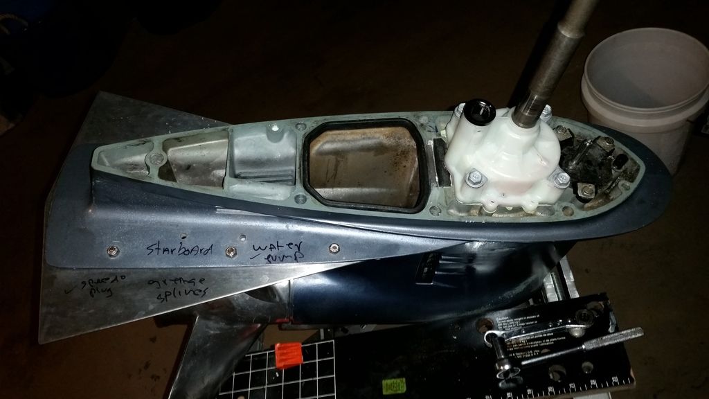

Here's some pics of the effort, and the oil was milky, but had a reasonable amount of viscosity in it.
When I replaced the lower unit oil I kept adding oil until all milky residue was gone.
I just ordered a mityvac 8500 to pressure test the seals - should be 10psi and hold. I'll add that effort to the thread. This one has the pressure AND vacuum seal check.
Confirmation that it's bad...
Housing unscrewed and seals out
Housing cleaned up
Buttoned up...
Some parts needed, seals labeled for next motor.

I found the original pic that started the effort...it started with a simple "Hey...let's replace that water pump." Classic boat project - you find one thing then another...to look at that part it's about as simple as it gets. When replacing the water pump just look under the housing plate and seal protector - course you'll have to get that woodruff key out to get there. I had to dremel and awl it out - about 20 min of work. No torches/heat.
This is what started things
BTW - I think this was the culprit; it appears to me they dry started the engine and heated things up enough to melt the water pump housing. Old vs. new.

Well...finally got things together and everything checked out. I used the oil pump that I use for the gear oil to pressure check the new seals. When I pressure checked the gizmo it was leaking air all over the place - right where the metal met the plastic. I redneck engineered that with a bit of Teflon tape.
Put the plug in place to the lower unit and lo and behold she held steady at 10psi.
While undoing the lower screw I noticed more milky oil - seems I didn't flush the lower unit well enough. So after several more attempts I buttoned her up. There's a touch more in there but I'll try again next time. I tried everything to get it all out, but eventually threw in the towel and was down to just a couple drops.
Time to get her on the water...and on to the next project.
Photos follow:
Mityvac with oil pump attachment (teflon tape to mate plastic to metal - eliminates air leak)
Attached to lower unit (found out that on a Yamaha you can mate to the top "Oil Level" screw as well)
Holding steady at 10 psi
Dang...more milky stuff...flush sevral more times.
The list of doom...
