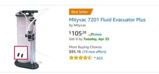

Pat get one of these they work great you can use to remove or add oil thru the dip stick tube.

PostPosted: Sun Apr 23, 2017 12:53 am    Post subject: Oil Change Reply with quote
Jody, Was this on eBay or ?
Barry Rietz
N9DXC
jkidd
Joined: 23 Oct 2006
Posts: 1627
City/Region: Northern, Utah
Vessel Name: Voyager
Photos: Voyager (JK)
PostPosted: Sun Apr 23, 2017 1:03 am    Post subject: Reply with quote
amazon.com
