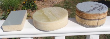

Wanna se some hull foam core and a transom balsa & marine plywood sandwich?
Go to my photos under WB Nod, second group.

Corecell foam sandwiches left and center; Balsa and marine plywood sandwich right.
Center and right: Atlantic 42 catamaran
Right: Saber 28 Offshore transom plug, "Windigo"
Should read
"Center and left: Atlantic 42 catamaran
Hi Foggy. I have looked at those but had a hard time figuring which was which.
No C-Dory plug though.

Hi, Harvey.
No, no C-Dory plug tho my 26 Venture was a core cell laminate (FG) something
like the center and left samples.
The powerboat transom plug was definitely all beef; a real big boy that ran with
the big dogs.

If memory serves me, the center plug was the cat hull.
The gray plug on the left was the cat bulkheads, deck, pilothouse.
Wondering the strength of these, one afternoon my bro and I took turns with
a wood splitting maul to each and could not break one; only a few nicks and
scratches in the outer layer. Tho not a true test for sudden impact, we agreed
the stuff was pretty tough.
Didn't come up with a method to test slow grinding thru the outer skin into the
core which would be NG. Some discussion of benefits of open vs closed cell foam
in case this were to occur. Concluded either was better than balsa if exposed to
water.
She slept real nice.
