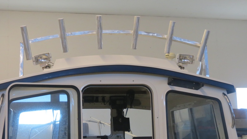

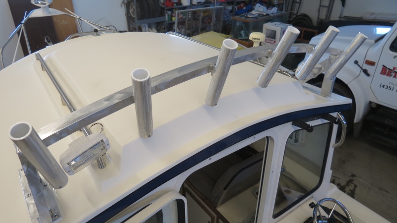

Here's one on a 22' Angler, that I built from aluminum. Total cost was about $75.00
Brent and Dixie,
1984 22' Classic sold 2003
2003 24' TomCat sold 2005
2006 CD 22' Angler Sold 2014
