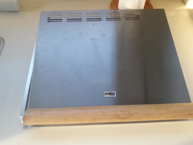

Is there a simple way to get heat into my v berth from my Wallas? The cabin heater works beautifully but the v berth and bathroom don't reap the benefit of it. I don't care about the bathroom being chilly.
I also have a basic CO detector in the cabin.
I forget the model number of my Wallas but here's a pic. It's a cooktop and with the lid down it blows hot air into the cabin.

We use an Ecofan on our Wallas. It runs on the heat of the surface you set it on. You would have to have the Wallas top up to use this type of fan. No battery drain.

So where does the fan mount to? Also, my model of Wallas says that the lid must be down to use it as a heater.

Ecofan's don't mount. They sit on the hot surface. Won't work in rough conditions.
For forced air heat into the V-berth look at installing an Espar or Webasto type of diesel forced air furnace. Many on this site have done that, including me.

Just a note on the use of the ecofan, scan Marine suggested that I not use one after repairing the Wallace on our 22. Inside the Wallace is something called a heat shield I believe it was seeverely warped. At night we would leave the Wallace on low and place the ecofan on the higher temperature plate, sometimes it would have to be moved to the side a bit to work properly, this would cause overheating on the Wallace due to the lack of heat transfer from the ceramic surface.
Scan Marine suggested we just leave the lid down and run the wallas on low it draws very little electricity.
