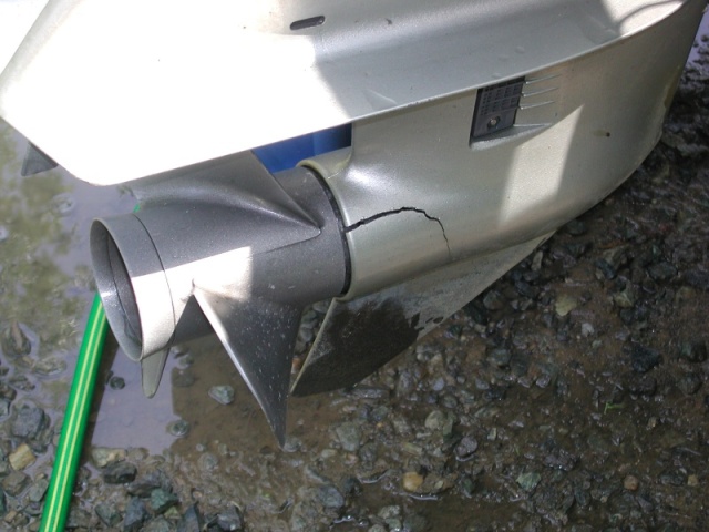

I have an 03' NOS Yami 75f. I hit a gravel bar last summer and ruined my aluminum prop. When I went to put on the new one I noticed that the propshaft was bent Cry . (600.00 repair bill). I would never count on the "hub spinning" to save anything. Here's a pic.

On my Honda 45's, the prop is on a splined shaft (horizontal) which is hooked to a pinion gear that mates to another pinion gear that is hooked to the drive shaft (vertical). I don't see anything that will "spin" or prevent damage to the whole unit should the prop suddenly stop. I would think that the aluminum prop would come apart a lot quicker than the SS one. It would be pretty hard to get something that big past the skeg/lower unit front end though, unless you were backing!! Smile
Older engines, smaller ones, had shear pins in them that would break before anything else but I don't think the big new ones do.
My lower unit damage was caused by getting fishing line wrapped around the shaft between the prop and the housing.
I'm in the process of replacing the whole lower unit with one from Halcyon's blown 40HP engine. The remainder of the engine will be available for parts to C-Brats on a no cost basis (shipping only). Will post that opportunity separately when I get the engine. Parts should be common to 35/40/45/50HP Hondas.
