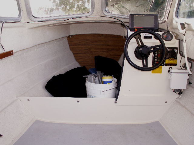

Here's what Pat Anderson had done on his 16 angler Crabby Lou. A few others have done similar modifications.

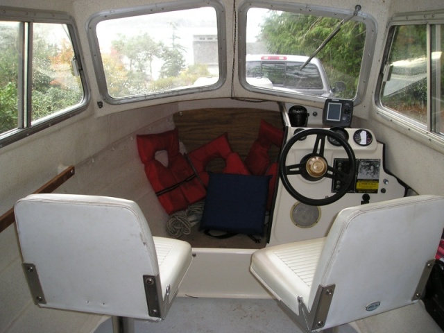

Here is a picture of the Alyssa Jean before I added a dash shelf.
Go to the album for more pics. 1st album on page two.
