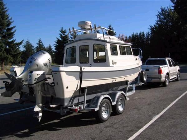

Here are some pics to share with the non-Ifishers...
I just have one strap for a tie down that goes across the boat just in front of the lazarette covers.
By the way, I would tow with the motor down or invest in a transom saver. just my $.02
You are gonna love it.
Did you buy up North from Les or from SC local?
Really? Dealer told us to tow with the engines up...the 90 has feet pressurized a bit so it doesn't slop around at all....hmmmmm

PostPosted: Mon Sep 26, 2005 11:31 am    Post subject: Reply with quote
If you read the thread titled Securing Boat On Trailer and see how the boats tend to move around, you will understand why you are better off without a transom saver. Sheesh - I always wish Les would get back on here, but I really hope he doesn't see the the above quote. He goes really haywire over that one.
