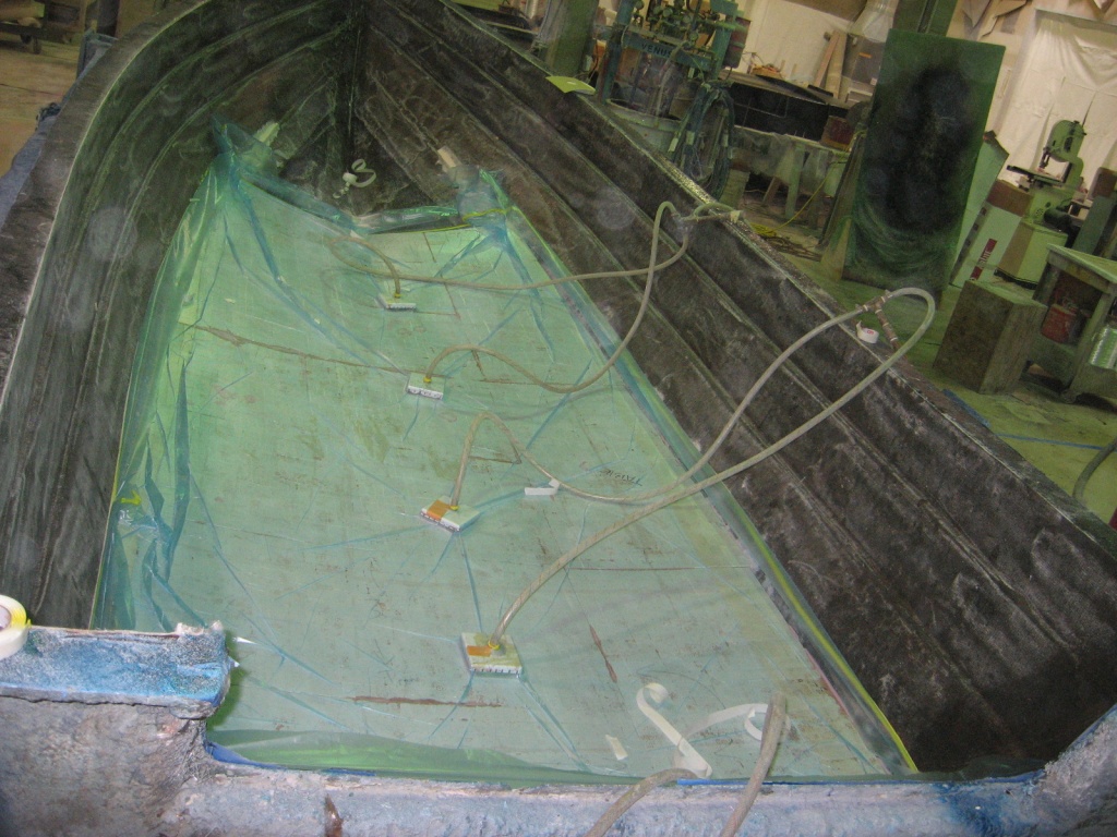

One way you might find out: Many folks have posted photos of their boats in the mold when they were being built. You might be able to see. (But searching the photos is not all that easy.)
PS: But looky here, an album with photos of the 22's being built - nifty:
http://www.c-brats.com/modules.php?set_albumName=album1219&op=modload&name=gallery&file=index&include=view_album.php
Here is one photo (although of course processes can change over the years) showing the core lying in the hull. You can see it is one continuous sheet of balsa. Can't see under it but as mentioned above, I doubt they were taking little pieces of balsa and stuffing them into the tiny keel (not that it wasn't a good question on your part).
PPS: On the other hand, there could potentially be a void in the keel space, and there could potentially be a gap in the glass that would allow moisture into the core. So as always, I'd say best to repair damage ASAP and also to check for moisture in the hull (as I would do on any cored boat).
