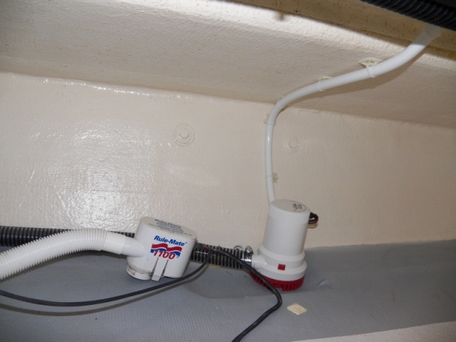

Oops. I forgot to post the link. I was talking about these. The are kind of an off white and match good.
http://www.amazon.com/Monoprice-Cable-mounts-25x25-100pcs/dp/B003L16ZYU?ie=UTF8&psc=1&redirect=true&ref_=oh_aui_detailpage_o07_s00
They are self-adhesive with double backed foam tape. That's what I was talking about when pressing them on. No additional 4200 is needed. They can be removed and the area cleaned up with some kind of a goo-be-gone product.
Here they are holding the wiring going to my bilge pump.

GREAT suggestion, Marco. I just put a 100 of them in my Amazon cart!
Then hang whatever on it.
Any idea how much weight (strain) they might hold? 10 pounds?

Don't know the weight figure, but if your attachment is good, these pads sometimes fail because the foam adhesive pad pulls apart (leaving half on the plastic holder and half on whatever surface it was bonded to). Also eventually the foam pad will degrade and come apart. Depends on the usage environment. If I want the mounts to be there a really long time, I remove the foam and glue the mount directly to the surface.

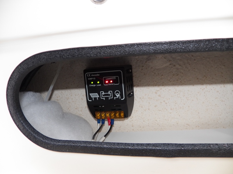

Probably not 10# each, or at least not for long. A pound or a little more is probably max, so they're great for running wiring, which is their intended purpose. I have used them on painted areas and it is the paint that has pulled loose as the weakest link. I've been using double-backed foam tape for a few non-crucial things and, if you're not asking too much, it seems to work great. Even if I assume that it might fail in a few years, it is still so much nicer than drilling holes in everything. I just attached a solar controller directly to the hull today with DB tape.
