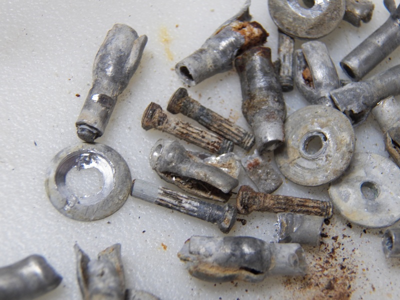

My 2005 CD16 didn't have spray-in foam anywhere. It had cut blocks of EPS. I think spray foam came later. Spray foam can lock things in place. I used it after putting things back together to give the boat a more solid feel. I still have a few spots to inject foam. I'm using a foam gun with a 3' extension of tubing to allow me to get foam into places where a gun/can can't fit.
Removing the throttle/engine electrical was actually the most unnerving part of it. The throttle/transmission levers have some small spacers, etc. I could have saved myself an hour of screwing around if I had labeled or taken pictures. I checked closely that the electrical connections were properly color coded before taking them apart. As I recall, I had one that was something like blue to yellow, but since it was the only outlyer, it wasn't a problem.
My throttle unit was through-bolted to the starboard panel. I thought that was strange, as the decision to go Yamaha must have been made at the factory. With the panel installed and foam blocks behind it, it didn't look like it could have been a dealer install. When re-installing, I went with oversized SS wood screws through the panel instead of bolts. I just couldn't see the need for putting three big bolts back in (and requiring the entire panel removed) when the throttle unit might need parts or lubrication in the future.
Have you pulled any of the deck rivets? Did they have the scary corrosion problem that mine had?
