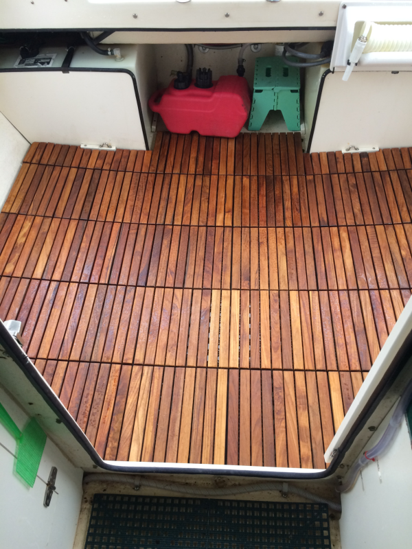

I pulled the trigger on these tiles that Roger found on Amazon. Easy install, and they look much better than the dridek mat I had down. The teak slats seem to be good quality, and are very lightly oiled. They should fade nice with the sun. Whole project cost under $250.00.
Thanks Roger!!!

Nice looking! How are they attached to the plastic underlay? One of the issues with Teak is that it is a very oily wood, and some glues do not adhere well. Epoxy (and I think G Flex by West) would problem be the best, if there is an issue, with slats coming loose.

They snap together like dridek. Screws hold the woods slats on. I have not secured them to the floor, I left them floating so the first mate can peel them back and run the wet vac underneath. I was out In a rough chop the other day, and the tiles were wet. I had good traction underneath with the sneakers. Seems like a decent product, time will tell.

You're more than welcome. For my boat (mostly used for fishing), they're "too nice" but I thought others might like them. They look great! Here's a larger version of the image for others to view.

For the deck it took exactly 3 boxes to do my configuration , with some scrap left over. You also need some stainless screws to re-attach the cut tiles to the matting, and a small drill bit to pre drill the teak planks you cut. I also used a Dremel to cut off the exposed black connecting nibs that were not needed .
Each box of tiles weighs 18 lbs.
