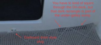

PS: Added photos:
This is the under-galley sump in my 2002 22 Cruiser. I realize this isn't what you are planning (and I don't recommend it really, in any case), but I thought it might be interesting to see anyway. In this first photo, yes, the core is closed out under the bulge - so there is no core at the bottom by the "slot."
The second photo shows it from the inside. The bottom of this sump is "core free" and is subsequently about 3/4" lower than the rest of the interior "sole." I imagine they did this to make is as sump-ey as possible. The photos aren't the best but I have them on hand.
