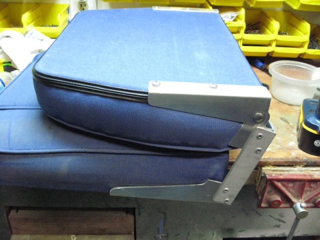

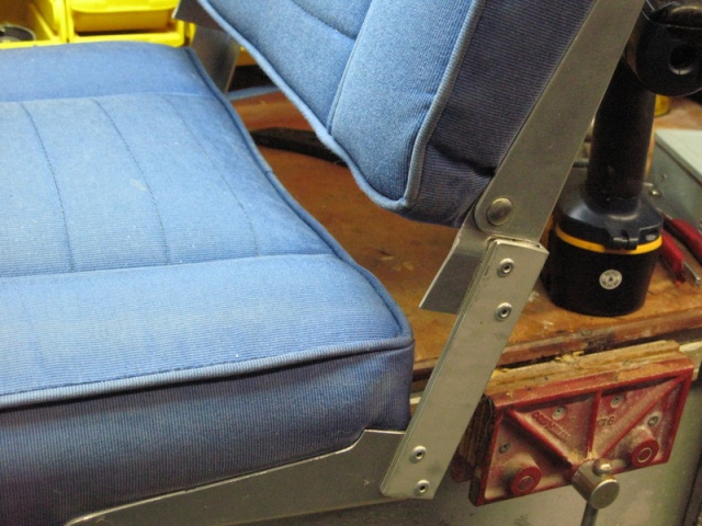

Got tired of sitting on plywood so re-stuffed the helm seat, than extended the hinges so the back would lay flat.
Will probable attach white cutting board or similar to the back of the seat.
Will make nice additional countertop for preparing those gourmet hotdogs and beans.
Full description with additional photos in album under projects.
Looked at buying a new lay-flat seat but times are tough; have to save for next summer’s adventures.

Awesome work!Thumbs Up Love the folding flat helm seat. What a great way to increase the galley countertop space. I too am thinking of copying your innovative idea to lay the seat back down flat. Now that you have done it, any regrets, problems, things you would have done different? How long are the aluminum angle pieces you used? Looks to be about 6 inches. Did you simply add the blue foam under the existing foam, replace the cover material and re-staple? Thank you so much for your advise.
