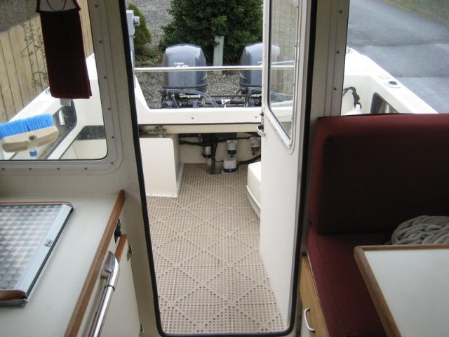

"..... If you have two pumps, one should be back at the stern sump, and the second should be inside of the cabin, which is where the 2006 C Dory 22 has the factory pump."
Is you forward pump, the one you are saying, I think, is inside the cabin actually set up to drain the cabin? On my 05, there is a pump, at the aft end of the "hallway" where there is a step and a small horizontal door over the "bilge", but that is set to drain the cockpit, IF the boat is loaded forward and the cockpit floor is then slopped forward so the aft pump and sump would be dry. The water access to that froward pump is through a slot under the door from the cockpit, not from inside the cabin side on my 22 Cruiser.
I learned that pump does not drain the cabin side one time after a rather vigorous washing process, with TOOOO MUCH water in the cockpit Shocked Laughing

Yes, the pump under the "step" of starboard pumps out the area of the cockpit when the boat is sitting in the water (normally does not have to be trimmed bow down--but, it doesn't take much water in the cockpit to make the stern pump also functional.
No, the pump in the cabin will not pump out the floor of the cabin. I found this out several times this summer. Apparently my vent tube or fill for the water tank in the 22 has a leak, and I got water on the cabin floor when filling up the water tank. This is another use for the plastic piston pump.
