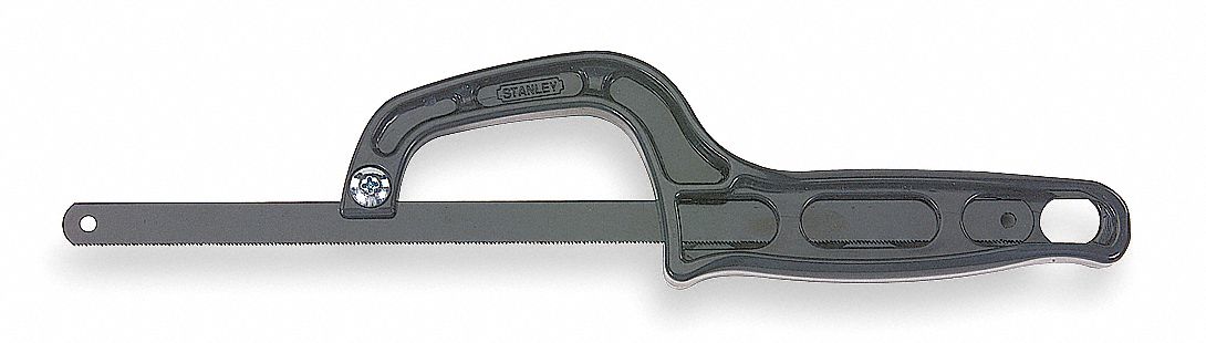

You all may think I'm nuts, but to keep the dust down I use a hacksaw blade after deelpy scribing the "good" side of the cut. I hold a vacuum under the cut and suck everything up as it is created.
I don't want to propose that this is the most effective and expedient means of cutting, but the cleanest and, for me, worth the time.
http://static.grainger.com/rp/s/is/image/Grainger/6XV45_AS01?$mdmain$
PostPosted: Tue Nov 24, 2015 2:54 pm    Post subject: Reply with quote
I don't think that's nuts at all. I have done the same in order to avoid dust -- especially at times when I had no vacuum/power and used damp paper towels spread around as dust-catchers. Anything to avoid fiberglass dust flying around!
