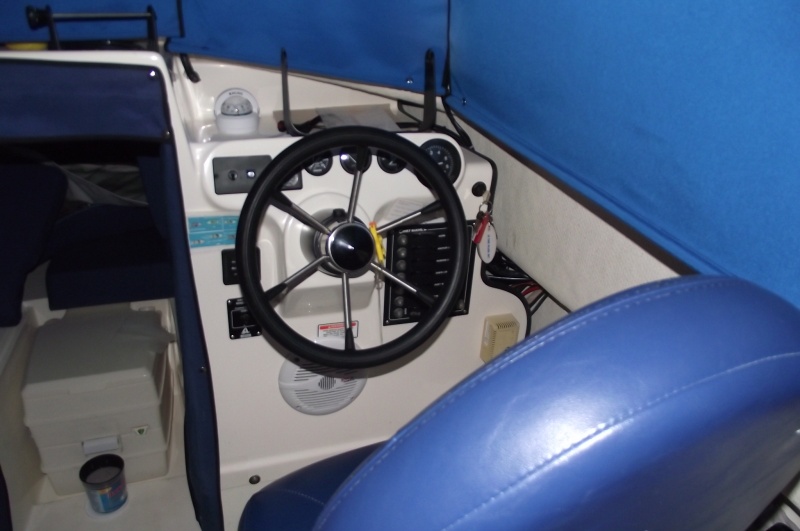

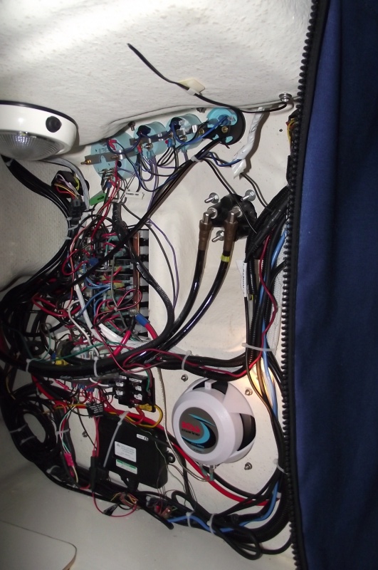

One of the first things I'll need to do is move some things around I think. The "electrical panel" behind the helm is quite the mess.
And the helm itself doesn't have much room left either.
So my plans are to move the Trim Tabs control to under the helm seat, and the control switches to the side panel by the remote (throttle.) I'm also planning on installing the autopilot control unitbox and hydraulic pump in the compartment under the helm seat as well. I'll place the autopilot control screen to the left of the engine gauges and move the spotlight controls to another location. Probably move the anchor windless switch to over by the throttle also. I'll remove the two smaller electrical buses and replace them with one larger one, thus cleaning up some of the wiring as well. Colby
Regarding my trim tabs control, has anyone else installed this somewhere else besides behind the helm bulkhead?

I did also order the installation kit, when I ordered the autopilot. I really don't have any room left on the back of my helm bulkhead, as one of the photo's above show. My plans for now are to remove the two electrical buses and replace with one larger bus. Also move the trim tab control box over to under the helm seat, along with moving the trim tab switches to nearby the throttle quandrant (just to the right of the helm seat.) Also planning on mounting all the autopilot hardware under the helm seat, except for the control panel (screen) which I will put on the helm bulkhead in front of me, close to where the trim tab switches are now. (The other option, would be to put the autopilot hardware under the berth, as I have removed the foam and installed a hatch, so that area would be accessible.) I had hoped to splice into my steering hose near the helm seat, but looks like with the kit I will need to put the Tee's at the helm pump (back of steering wheel). The kit comes with 25' of hose, so I should have plenty to make that 5 or 6' run, but that just means all that more hoses/wires coming from behind the helm. I think with replacing the fuse panels with a larger panel and moving the trim tab control box, should clean that space up nicely. There will still be a lot of wires and hoses back there though. Colby

Colby, Its' your boat so you can do what you want to do, but if it was me, I'd start with:
1. Move the coffee cup from in front of the port a pottie Laughing to save on the confusion that might cause Laughing Embarassed
2. I would want the Trim Tab switches to be where I could see them. (from your first post here --
"So my plans are to move the Trim Tabs control to under the helm seat,"
3. I would consider moving the speaker away from the electronics (Just my issues about magnetism and navigational equipment.)
It sounds like you are planning on moving a considerable amount of equipment. Would it work to just move the switch panel down some, and put the AP panel where your current switch plate is? I use my AP (EV-100) a lot and it is something you will want to have ready access and visibility to, easily.
Buy the way, Your wire "nest" behind the helm panel looks like it is related to mine Rolling Eyes Thumbs Down
