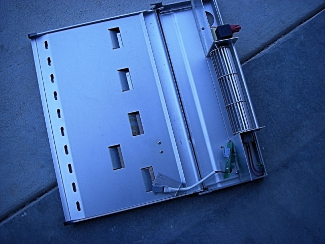

Well, how about that. The darn thing died this summer on Journey On and I'm going to share what I found out.
First, we got through the summer with an ECOFan which is actually better than the lid fan. First, the E-fan is quiet. Second, the E-fan can be pointed at the V-berth so it warms that place up a little before you get out. And, finally, the E-fan doesn't wear out.
Second, while on the trip, I called Mike at Scan Marine for advice. Mike is a very helpful person, pointed out the switch is $75 and he would replace it if we dropped it off, for the $150 cleaning fee. This later grew to $100 for the part and a bit more for the installation. Fair enough. However, Mike pointed out that a 5 yr/old Wallas needed several more parts replace to guarantee reliable operation.
Third, so this has become a home repair job. I pulled the Wallis out with the help of Tom/Primitive PDF doc: Wallas Stove Service . He doesn't mention the lid, but the aft screws on each side remove the lid, which is shown below. You'll also have to disconnect 2 sets of wires, one to the lid switch, the other to the relay.
[/img]
You're looking at the bottom of the lid/cover, with the blower fan on the right, at the rear of the lid. The black cube at the top right is the power relay which drive the fan motor. The most important part is at the bottom right and is the lid blower switch, complete with junction board and a thermal switch. The problem seems to be not with the micro-switch, but corrosion on the board. That's the $100 item, and I'm not questioning the price. What I'm worried about is that Mike said that switch is prone to die, since it's in a place which catches a lot of crud.
My plan is to replace that microswitch with a manual switch that can be turned on when we want heat from the Wallas. Have one i bought for $5 from the auto parts store, and I'll mount it at a distance from the stove. That switch only drives the relay, so there's no real power going through it.
At the same time, I'll follow Mike's suggestions, and replace the start-up motor, etc, etc, as detailed in Toms document. that should only be ~$100 in parts (at this time.) And after reading the above, you may want to send that stove to Scan Marine. I figure the total bill would be ~$500.
By the way, just to make you happier, it was mentioned that the Wallas 85 model, introduced right after we bought Journey On, fixes all these problems. The story of my life.

All good stuff from Boris.  One other thing you might check is the fan motor & if it's running but the fan isn't then the motor shaft to the fan bushing.  On our last Southeast Alaska cruise I had to tear the Wallas down as show by Boris in Sitka, Alaska.  The shaft is superglued to the bushing & found the glue had failed.  Repaired that but in the process of checking it applied direct 12 V to the fan motor & found out quick that's a no no.  Voltage fed back & took out the switch & junction board shown by Boris.  Thought at the time it was the main control board it took out so ended up without the Wallas for the rest of the cruise, which was over a  month.
[/img]
