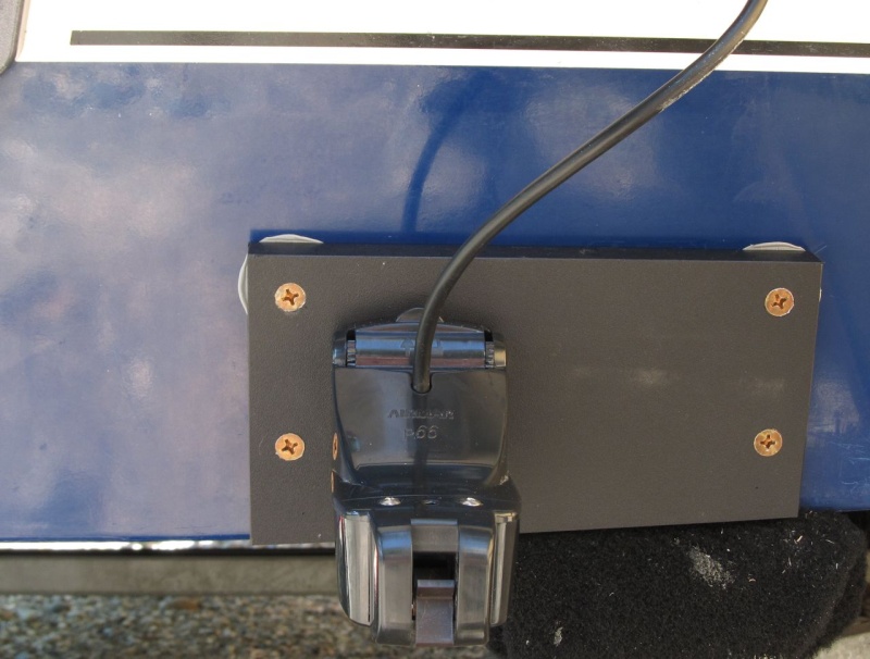

Personally, I don't think it's ever silly or overkill to think about properly sealing off core - especially beneath the waterline. But then I've done a few re-core jobs (not C-Dory), and hope to never do that again. In comparison, closing out the core before problem happens is easy and cheap!
I don't think Starboard can really be trusted to keep a seal (i.e. to unprotected core under it) both because it is rather sealant resistant, and because it tends to "creep."
As always, there are many effective ways to go about it, but here is how I prepped and mounted the Starboard transducer mounting block on my boat:
1) I overdrilled (with much undercutting and core removal, such that the hole that actually showed was just "the tip of the iceberg") four holes in my transom, then treated them with neat epoxy, then completely filled them with thickened epoxy. I planned these to be in a suitable location for the Starboard block.
2) I then drilled and tapped holes into the new epoxy "plugs."
3) Drilled countersunk clearance holes in the Starboard, used some butyl sealant as bedding (although core is completely closed out), and then mounted the block with bronze, flat-headed machine screws into the tapped holes. I prefer bronze in holes that will be oxygen-derprived such as these.
I made the four holes at a spacing that would allow a larger block to be attached in future, should I want to change the one I have (which will fit two transducers). Then I tapped the Starboard and attached the transducer.
Interestingly, I decided to remove the Starboard block to slightly adjust the angle on the bottom edge, and MAN, that butyl hung onto the Starboard like crazy. I wasn't really expecting that since Starboard is typically hard to bond to (and really I only used the butyl as bedding - in small "rings" around the fasteners - since I did not need any adhesive quality).
This photo shows the nearly finished product (hadn't cleaned up squeeze-out or secured transducer wire yet).
Again, there are many good ways to go about it. The one constant for me is that I don't trust any caulk (or similar) to protect the core, especially below the waterline. The reality is that a trailered boat stored undercover may never absorb enough water to be a problem; but my specific brain could never relax at anchor that way, and I didn't want to be thinking "Gosh, I could stay out another week.... but.... hmm, what about the core...."

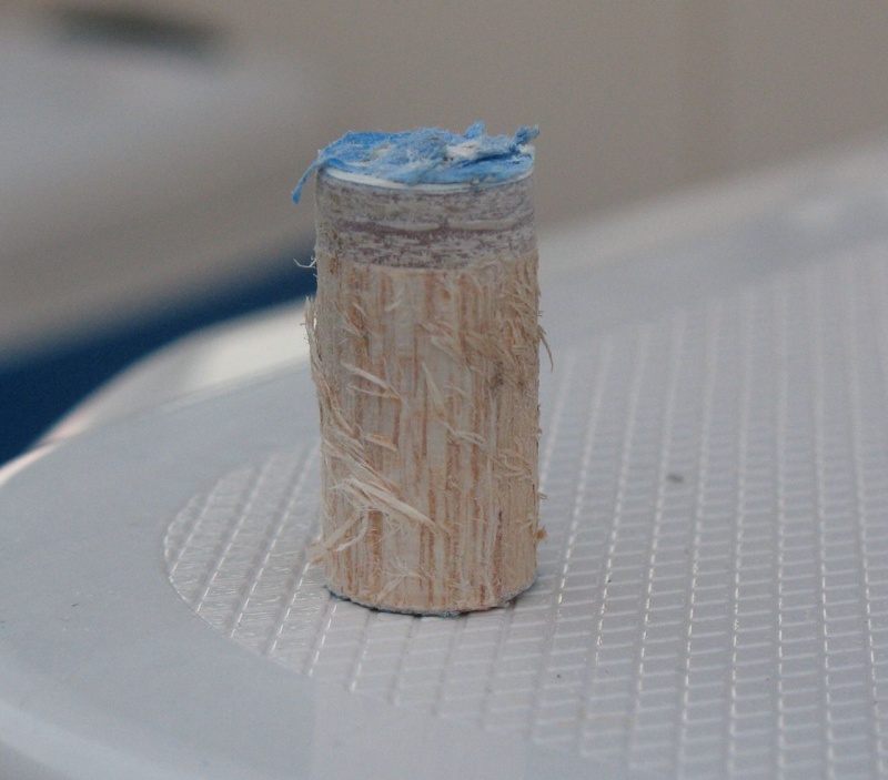

I was looking back in my photos and I'm 99% sure this plug came from my transom when I was overdrilling the holes for the Mini-jacker mount. I have a 2002 22 Cruiser and the transom core is vertical grain balsa. This would be the outer transom skin plus the core (inner skin stayed on boat). I realize there is no scale, but I think the fiberglass layer you see is around 3/8" or so. At any rate, the transom is around 1-1/2" thick.
If you get up into the splashwell area, then there is an additional "layer" of white filler and another inside skin (molded splashwell). But the inner transom skin is still there, only sandwiched in the middle like the middle bun on a Big Mac.
