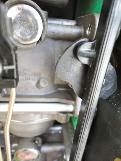

I have removed all of the old fuel from the tanks, and put in new fuel. When the engine was shut down, the oils were changed, and carburetors drained. The tanks had 2 gallons on the port and 6 gallons on the starboard tanks. This was treated with Stabil and Startron--but it smelled stale, so discarded. As I was priming the carburetors, I noted fuel leaking from under the cowling. On examination, the fuel was coming from around the dime sized disc on the upper part of the carb:
The silver disc in the upper left corner. First any idea what this is, and why it is leaking? (Pressure relief?)
The engine was put up a little over a year ago, and running well then. I did kick it over, for a couple of turns (less than a second) and it appears that fuel is coming from under or around this disc.
I didn't find the exact part on the internet, but may have missed it somewhere.

PostPosted: Fri May 30, 2014 12:00 pm    Post subject: Reply with quote
ok to guess?
fuel vent

I think the float is on the over side on the disk which I call a vent
Posts: 21387
PostPosted: Fri May 30, 2014 2:06 pm    Post subject: Reply with quote
Brent you are correct. My first thought was a stuck float--but this cover was so far from the bowl, it seemed to be too far away. I stopped by my Honda Dealer--yep--that cover is over the bowl vent--which runs thru the body of the carb past the air intake...

Every time I've been confronted with a pressed-in cover plate on a carb there has been a spring controlled enrichment needle valve behind it. In your photo there appears to be a "notch" in the aluminum carb casting. Does this notch exist in the other 3 carbs? (it's dark and raining here in ME or I would pull the cowling and look for myself) If the notch is normal, perhaps the disc is loose/distorted? There should be an overflow vent tube from the float bowl to drain fuel if it is a stuck float. If the "notch" or warped disc is the problem, perhaps some fuel safe epoxy judiciously applied could solve the problem.

The other carbs all have exactly the same plates. There is even a U Tube video showing the fuel pouring out from these vents in case of a stuck float valve. So I fear we are on the right track--just why did it happen--is the mystery. It must have been that E 50 I was forced to use in California two years ago Teeth
My best guess is that somehow there was enough "gunk" already in the bowl from some use of the ethanol. We had stored the boat for about a month at Lake Powell, and had not drained the Carbs then. I had actually used ethanol fuel in Calif--since pure gas is almost impossible to find in S. Calif shortly before we stored the boat at Powell. The boat ran well, but I suspect that some gum or varnish had already formed and during the time the float was at the bottom of the bowl, it became adherent. Now that I have seen the carbs torn down, I realize that the wire will not work, even if I were to get it into the bowl--which will not happen….
