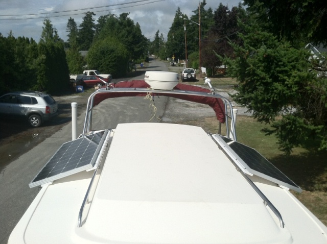

Casey, if I were doing it over again, I would get two 100 watt flexible panels and mount them on the bimini, facing straight up to the sky.
As I see it, the objective of solar panels is to replace amp hours drawn from your house bank by your loads during the night (usually). If you track amp hour usage with a Victron battery monitor (HIGHLY recommended), you will see that a small panel could possibly keep your battery charged when there are no loads or minimal loads (i.e., during storage) but cannot possibly keep up with a fridge or freezer. The pole mounted solar panel that could be tilted and turned that we saw at Powell was cool hardware, but too small to be really useful (maybe whoever built it will chime in, but as I recall it was something like a 30 watt panel).
Ranger Tugs have a 250 watt panel mounted flat on the roof. Less ideal than being able to track the sun, but their experience has been that one 250 watt panel pretty much makes up the amp hours used by their loads overnight.
We have two 100 watt Renogy rigid panels on Daydream. They were $389 with the controller and free shipping. My mounting location is pretty much the only place I could put them. The cabin roof is required to carry the dinghy or kayaks. I do not have the mechanical skills to fabricate something large or complicated to allow turning or tilting two 100 watt panels to follow the sun. I do not see rigid panels on the bimini as a particularly good idea structurally, plus we like to take the bimini down when we trailer. So my panels are hung from the roof rails over the outboard wings of the roof.
I am thinking about installing two supports on each panel to raise the outside edges to make them face straight up toward the sky, which would capture as much sunlight as is possible in a system that can't track the sun.
Performance wise, these panels have done great in the PNW, much better than at Powell. I think that is because we were always in a canyon where the sun came up late and went down early because of the canyon walls. Still, even at Powell, while everyone else was running their Honda generators every day while we were at Oak Canyon for a protracted period, we only had to run the generator once in two weeks.
Flexible panels would be easy to manage, you could leave them in place or take them down, figuring a way to secure them would not be difficult, and they would be easy to store when not being used.
Just my $0.02 worth!
