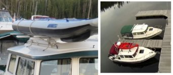

We have a Sea Eagle Fast Track 485 and have really enjoyed it as a tandem kayak. It's a bit longer then the 385. We added an extension to our wooded rack to give more support. It works well. Our simple wood rack is light, cheap and easy to remove for winter storage under a tarp. Here are a couple views. Also in the image is Voyager with what I believe is a Thule rack.
