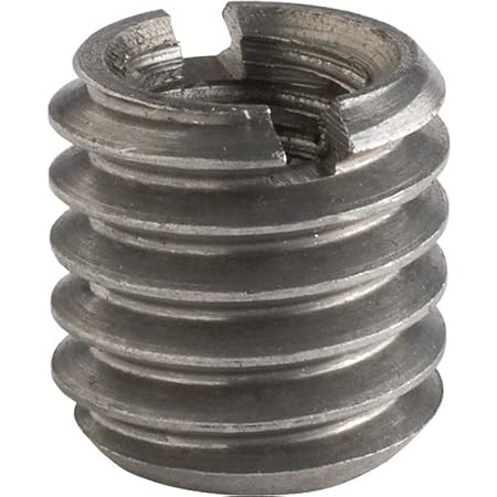

I have used the inserted barrel threads into epoxy on another boat, and used flush mounted SS hex head set screw to keep the threads clear.
The one pictured is 1/4" thread, but they are available on up in size. 1/4" should be fine for what you want.
This avoids having any tabs or other obstruction on the cockpit floor. You can then use machine screws to hold the tabs in place with the bait tank.

The reason I used the hex head set screw, is that the barrel nut is set flush to the floor. The set screw in place has no protuberance above the deck level. This is small, and you will not slip, stub a toe, trip etc on it. The set screw also prevents any water from getting into the barrel nut.
