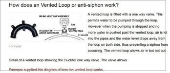

Interestingly enough, the C-Dory 25 has 3 bilge pumps. For each, the builder (whoever it was in 2005) routed the output/overboard line up above the pump intake (good), put a coil in the line at the highest point (bad) and the led the hose to an overboard discharge (mandatory.) I assume all C-Dory bilge pumps were installed in this configuration.
If not, and water entering the overboard port would just drain back through the pump and , voila, you've got a wet bilge, or cabin, or sump.
There's another aspect to having a coil of hose to prevent ingress of sea water, which I found out the hard way. If there's enough residual water in the coil the pump might not generate enough pressure/head to work. Remember, those bilge pumps are centrifugal pumps and they have a lot of clearance to pass "stuff". so they need a clear shot to the overboard fitting.
The recommended installation is to use a vented loop at the top of the overboard hose, which should be a foot or 2 above the pump outlet as shown below.

I have never seen a vented bllge pump loop in a C Dory. Generally they break the siphon effect, and the water runs back down into the sump.
Siphon breakers/vents often clog up. I have had them on heads. and also on exhaust on generators etc. In some of these cases, I have gotten ride of the small valve, which plugs with salt, and vented these straight out thru the hull, up under the gunnel (not on C Dorys). With a generator, it is great, because then you have a "pea" stream out the side of the hull, confirming that the water pump is working well.
PostPosted: Mon May 04, 2015 9:06 pm    Post subject: Reply with quote
Wouldn't a siphon break only be necessary if the discharge through hull were below the waterline? Maybe it is on the 25, but on my 22 and others I have seen it is above the waterline. With the output above the waterline, it seems like there wouldn't be a source to "feed" a siphon.
I have an upward loop on the bilge pump hoses just inboard of the through hull to keep nuisance water (and as much of the pumped water as possible) going overboard, but I don't have a siphon break. I have had them on previous boats, say on the head discharge wherein both the head itself and the discharge through hull were below the waterline.
