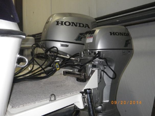

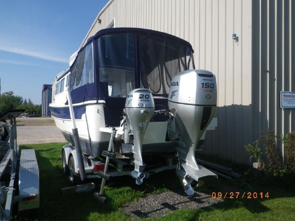

That is an interesting question Ron. The advantage on the Tom Cat is a considerably larger cockpit. However in this boat, there is an ice chest in the splash well, and apparently no higher transom--unless I am missing something. Also there is no actual floatation in the bracket (again hard to be sure, looking at the photo). (They say "designed to provide neutral buoyancy.) Armstrong makes a very good bracket. The Rosborough 246 does gain cockpit room with the bracket--and it has a more round chine. I have seen both narrow and full transom brackets on the Rosborough 246.
There is a 150 plus a 20 back 2 feet further aft. This equates to more leverage on the transom, and perhaps different handling characteristics. The motor should be mounted a couple of inches higher. I do see a hydrofoil (Permitrim)--I consider this a plus in any C Dory. But wonder if this person put it on because of handling. The comment is made:" The mount was also scalloped for hydrodynamic efficiency and stability in a following sea. " I am not familiar with this technique.
My suggestion is that I don't see a lot of advantage, but it does give a nice big swim step, and diving ladder.
PostPosted: Sun Mar 08, 2015 1:44 am    Post subject: Reply with quote
I think Bob is right on with his assessment.
I'd personally prefer a full enclosed bracket with flotation, but wonder how either one would affect the handling characteristics of the boat, particularly in large seas, and especially in large following seas.
I would really want to test this boat out along with someone who was very familiar with how the original CD-25 handles to evaluate the adaptation out.
Here are the two photos of the bracket in order to facilitate this discussion:

Thanks for posting the pictures Joe. According to the broker write up the boat is supposed to perform "better" than stock. I am quite sceptical of that comment, which is why I was hoping someone here might actually know the boat.
Like you Bob, I can't see the benefit of the bracket unless you also remove the splash well and close in the transom notch. I really like how the bracket works on the Rosborough so I have often wondered if one could be added to Meander without effecting the overall performance too much. If I ever considered doing it, I would remove the splash well and fill in the notch. The added cockpit space would be great to have.
I wonder how the the extra weight further back would affect the performance. Would it cause the boat to porpoise, ride bow high and how would it effect the fuel burn. Of course the cost of doing it would probably just make it more sense to just buy a bigger boat! Shocked
