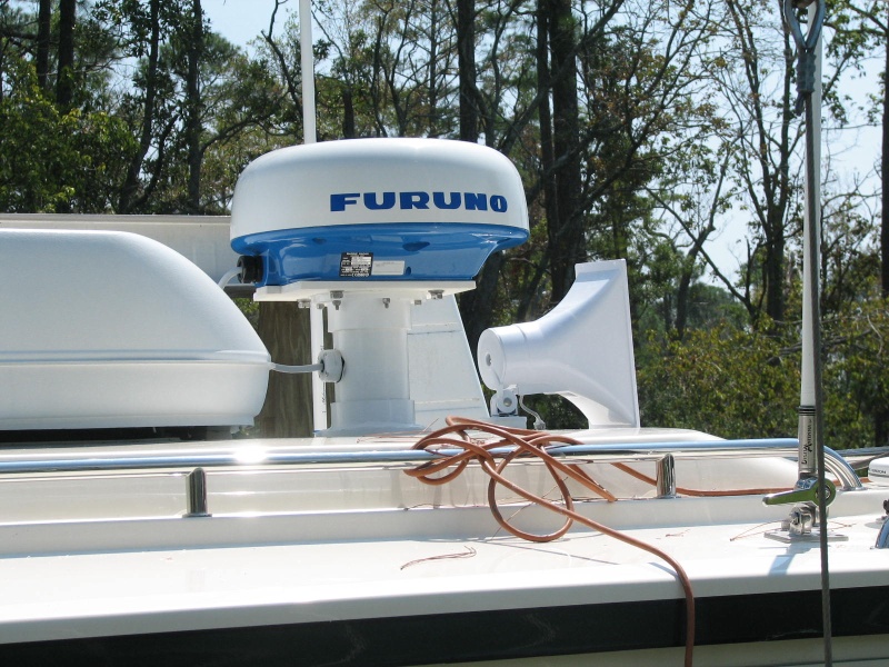

Which leads me to the question of acquiring a radar arch. Bob and others, is an arch and the slight gain in height worth an extra $1,000?
And, yes, Bob, an em-trak B100 AIS Class B Transceiver is on the list. The Admiral fell in love with AIS during several foggy days in Maine this summer when we cruised with Bruce and Joan Kessler aboard Spirit of Zopilote. Fog will be a factor for a good portion of the intended route.
--Georgs
Posts: 20814
PostPosted: Mon Oct 05, 2015 9:34 pm    Post subject: Reply with quote
Thanks Georgs. Yes, the 840xs does have all of the same features. Do a mock up, and see how both of the sizes fit at the helm. At first, I thought that the 10" was too large, but then I put it in place, and it did not obstruct my vision. (I also have a 740s and a 540s on the "dash'.)
I have used my "commode mount" for radars, which may be very close to the roof. (Using standard WC parts from Home Depot), In the current installation, the strut came with the radar, so it put the radar above the dinghy. I have not used a Radar arch on a C Dory, and for me, the only reason would be to put a dinghy under it, get antennas off the roof, and out of the way, and put on fishing rod holders (also can work as an additional hand hold). The gain in height is not worth the $1000.
Commode mount on the C Dory Tom Cat 255:
