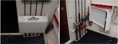

Wow, what a great setup...but there's no name of an owner? Is that a homemade or casted cover?

This one?
That is on the now Judy Blue Eyes, formerly the TyBoo(22). Its purpose was to secure the fishing poles in the outside rack when overnighting at the dock.
Is is just fabbed up out of some PVC lumber for the sides, plastic cellular sign board for the front, and covered with a single sheet of 1/4" clear polycarbonate with a bend on top. The decal is between the white cover board and the clear. It isn't theft proof by any means, but it will cause the thief to make enough racket getting it off that the guy sleeping inside the boat would wake up. It is "locked" with a threaded rod from the inside of the cabin. When opened, it just lifts off the hinge to get it out of the way.
In other words, he works miracles.... that Tyboo Mike is one special craftsman. Thumbs Up {insert icon for green with envy}....
