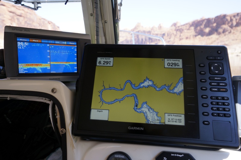

I faced somewhat the same issue. I had purchased a 740S (older) for the Radar, and found the screen too small when split with chart or sounder (I was used to at least 7" with a vertical orientation--giving more forward view in large boat radars).
I then added a 1041xs, which allows excellent overlay with the fast GPS update, or a good vertical orientation better than the 7" screen for Radar.
Normally I run the conventional sounder on the 740, as well as the down scan on the 1041xs, plus a chart or radar/chart, or radar chart overlay on the 1041xs. I also have an older 541 which I have now dedicated to AIS.
The 541 is just off to the right of the photo. This set up gives me great redundancy. But, if you are short, you may want to see how the 1041 fits with your vision forward. I am (was) 6'2", and it is fine, but for shorter folks, without revision of the seat, it could block view.
The down scan is a supplement to the standard fish finder, and is very handy in looking at fishing bottom, as well as anchoring sea beds. I do not yet have the side scan or CHIRP additional box. Probably that will be the next purchase. Both of the fish finders held the bottom at over 400 feet and cruising speed.

Bob,
That's a great picture - thanks!
I think I'll add the Garmin 741 above the helm and keep the older lowrance 113 as a sonar until I pull out in a few months.

In my photo the 1041xs is on the plastic mount which came with it. The 740S is in an aluminum mount I made, it meets the bottom of the 740, so there is virtually no gap, and it is held in place with heavy duty velcro.
The only swing or ram mounts I have used for MFD displays were in Motor sailors where I wanted the mount to swing so I could see it from the pilot house, or the cockpit (in the companionway). The 1040 is a large MFD display, so you want it as near to the console as possible. I just screwed it directly into the fiberglass on top of the console. In some boats I have put the Radar up under the shelf above the helm, but then it seems best if you have upside down trifocals, for good vision!
