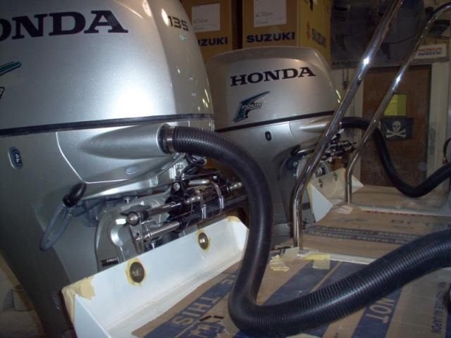

Check the position sensing cylinder, probably on the starboard motor steering ram. It may have come loose and is way off center.

PostPosted: Wed Sep 17, 2014 10:09 am    Post subject: Reply with quote
The position indicating ram is the lower cylinder on the starboard motor in this pic. Held in place by the two stainless bands. It provides input to the autopilot to indicate whither the motor is pointed to the left, right, or straight ahead. It needs to be centered on the steering ram. I had a bad ram on our 24TC and the autopilot would only turn to port.
