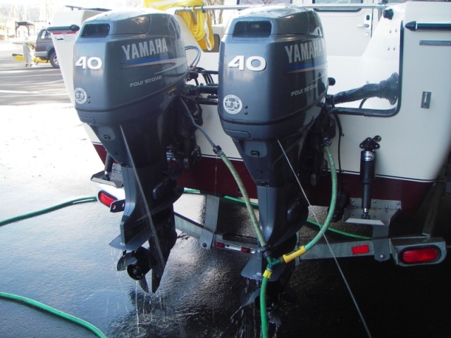

Not where I can measure now, but I believe that is about the size I have. I would consider going larger, extending farther aft and VERY firmly mounted. I think they would be more effective, and I could provide a stepping spot for re-entry into the boat should I take an unplanned overboard experience. I too have twin 40's without the Permatrim's, and can easily see stepping onto the lower unit and the up onto trim tab before reaching the splashwell.

PostPosted: Fri Dec 26, 2014 12:35 pm    Post subject: Reply with quote
Just at the bottom of the Splashwell. Not sure of the technical name but there are the little "half shell, scoop covers" over the lines. Does work as a minimal secondary splashwell drain at each corner.
You can just barely see them in the picture.
