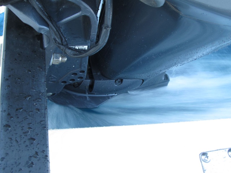

PostPosted: Tue Aug 12, 2014 1:38 pm    Post subject: Reply with quote
I can't speak to the pits on the prop, as that is outside my knowledge. However, from reading and talking to various folks, I get the idea that often engines are mounted a bit too low. This is because if they are too high customers will come back and need tweaks; whereas too low can be lived with. So it's "safer" to mount them a bit low.
There is a thread in the archives where I was asking about various props/WOT/etc. for my boat, and someone linked me to a discussion on another forum showing how the leg of the engine/Permatrim/anti-ventilation plate is supposed to look when at speed. An identical photo of my engine shows that it is too low in the water at speed as compared to the best position. I plan to raise it to the top notch (will be around 1.5" higher than now) and test that.
Another 22 owner did just that, described here (handy for me, it is the same engine/dealer who did mine, which is at the same height). Figured you might be interested to read it.
http://www.c-brats.com/viewtopic.php?t=19517&start=0&postdays=0&postorder=asc&highlight=
Edited to add: Here is a link to the posts on engine height that I mentioned above:
http://www.veradoclub.com/smf/index.php?topic=137.0
The photo from that article showing "too low":
My engine (hmm, looks very similar!):
The photo from the article showing "just right":

PostPosted: Tue Aug 12, 2014 2:07 pm    Post subject: Reply with quote
The anti ventilation plates on our motors are at the same height as the bottom of the hull. On plane they are under water.
I raised them one hole to get them out from under water while underway hoping for increased efficiency and perhaps a bit of bow down attitude.
The hoped for benefits were not significant but the prop ventilated with a small amount of upward trim and vibrated with down trim.
You should be safe with the AV plate at the height of the hull bottom. Depending on where the motor mount holes were drilled a you may be able to raise the motor a bit above that.
