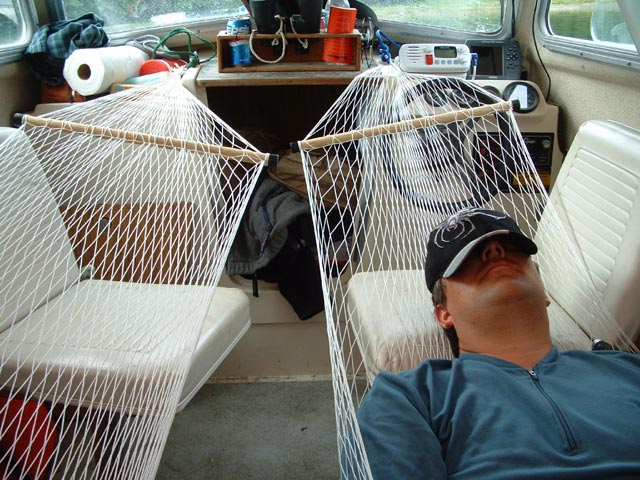

The last trip on my 16 Angler, I took her out 75 miles from port over a three day weekend with the wife. Logged close to 200 miles (statute) on that trip running a 70hp 2-stroke Johnson fed from a pair of 24-gallon saddle tanks. I strung hammocks from the helm to the transom and rigged a tarp over the cockpit to make an enclosure for sleeping.
Than you for the input. I would be interested to see how you rigged the hammocks?
Cheers
Chris
PostPosted: Mon Jul 28, 2014 6:16 am    Post subject: Reply with quote
Chris, there are pictures in his album!

Posts: 5927
PostPosted: Mon Jul 28, 2014 6:45 pm    Post subject: Reply with quote
Here's the one picture of the hammocks I could find. I'm not sure how they were attached at either end.

PostPosted: Mon Jul 28, 2014 9:39 pm    Post subject: Reply with quote
If you look closely, you might be able to see the cleats...

PostPosted: Wed Jul 30, 2014 11:34 am    Post subject: Reply with quote
i zoomed in and located the cleats. Mounted on the thick Fibre glassed rim of the cuddy door. This is definitely one of my future projects. Thanks for the picture.
