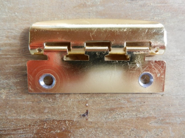

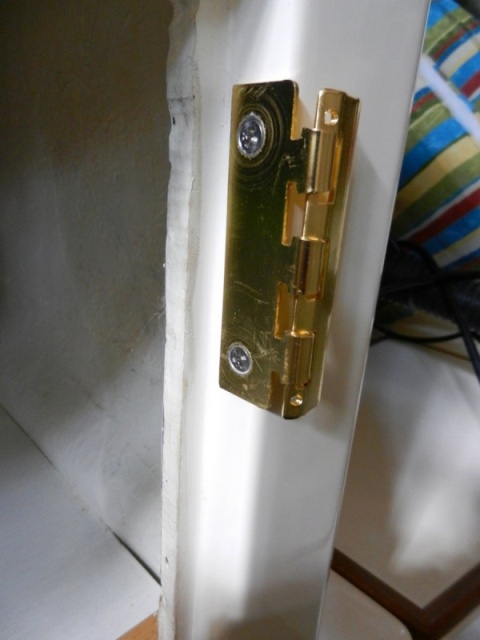

I figured out that the mounting tab could be cut off to allow it to be mounted on the 1/2 to 3/4-inch inside edge of all of the fiberglass cabinets. Here is the mounting tab cut off shorter.
Then I had to reproduce the countersunk holes so that the screws would sit flush with the metal surface and clear the cabinet door edges.

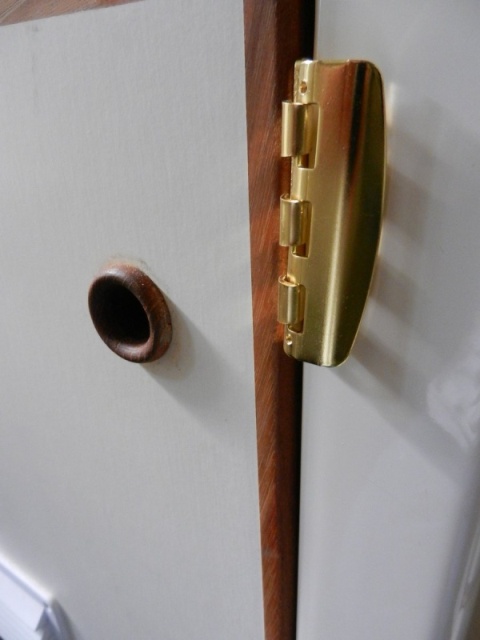

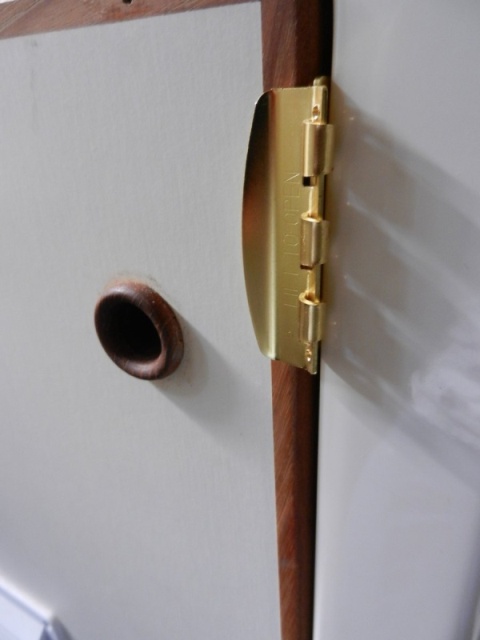

This is what they look like mounted to the cabinet door edge. The screws just go into the fiberglass. Don't try to use brass screws into fiberglass. They just melt/fold over like butter. I bought some stainless ones.
OK, it's not the prettiest install, but the door covers it up most of the time. Here it is locking the cabinet.
And here is that cabinet unlocked. When the boat is anchored/still, you can just leave them unlocked all the time and there is none of the slamming going on!

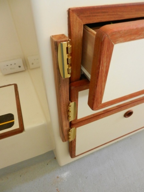

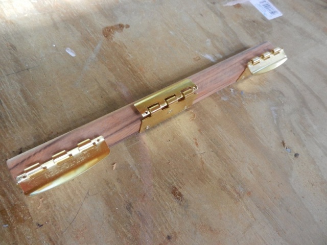

For the drawers, I needed a right angle mounting that was orthogonal to the drawer face. I cut a piece of teak that was the same height as the drawer faces and mounted three of the latches to the teak bar.
Then I could just mount the bar to the face of the drawer cabinet.
The drawers are VERY convenient to be able to leave unlocked at the dock or anchor and not have to slam them all of the time.
