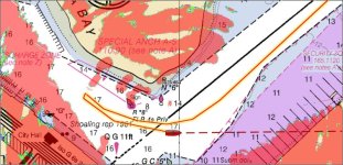

I’ve been working to get openCpn to display the Lowrance 3g image. I finally got it working in the driveway and this week took it down to San Diego Bay. I’m thrilled, and here are some screen shots.
The first shot shows Journey On headed out of San Diego Bay. The course is stable and you can see the correspondence of the radar with the chart. Notice the radar plot over the bouy markers. That 3G certainly displays detail under about 1 mi range. Those radar signals above the Special Anchorage note are indeed boats moored.
