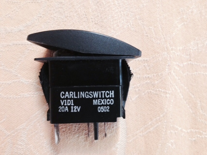

There are few markings on the switch. When I removed it, I expected to find a model number or something; but that's the heart of my problem, there is little to go on (see photos). I looked on the internet and found lots of Carlingswitches (100s of them). The question is which one will match.
I can see from my research that the replacement is likely the V-series Contura V, but I can't be sure. I'll do more thorough research and order whatever seems right. I'll report back.
(I can't figure out how to post photos here......I will figure that out and post them later. Suffice it to say that the only markings on the switch is; "Carlingswitch V1D1 20A 12V Mexico 0502")

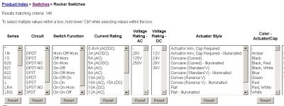

First off, thanks to DuckDogTitus.......since he/she lead me to the Digi-Key site. This was the best place I've found to explore the many hundreds (probably thousands ) of Carling Switch models. It turns out that this basic switch product is sort of like an "Erector Set" in that there are just a few simple parts, but they can be put together in hundreds of combinations -- each combination being its own unique item with a unique model number. (If you know how to read the model number coding, one can figure out the features of a switch from that model number.) The Digi-Key site that DuckDogTitus provided organizes this process very nicely via the following interface:
Using this Digi-Key interface, I've narrowed down the replacement switch I need to the following:

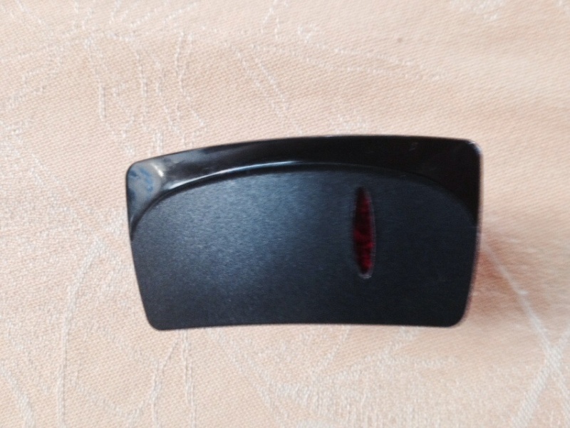

Someone asked about photos of the switch I removed, here they are (note no model number is stamped on the switch. I can understand this from Carling's point of view given the thousands of possible combinations):
