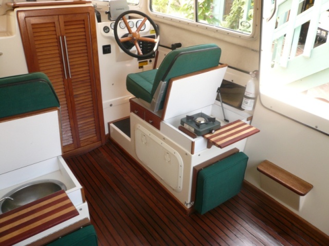

I'm gonna be adding a single burner stove and sink to my 19. Here's a picture of another Brat's 19 for reference.
Any tips or suggestions for what kind of burner to get? Do I have to worry about heat dissipation and venting? I'm assuming the base around the burner will be insulated and not get hot; sort of like how those portable propane heaters only get hot in the main area. First I was thinking of just getting a small propane grill and then installing a gunnel mount but I like the clean install of single burner behind the helm.
What about the sink? I'm not looking for an electric setup and water pump. I'm thinking of just having a hand pump system and then a small receptacle for waste water. I'll just empty it myself.
What should I be aware of when drilling/cutting into the seating box (I don't know the proper name for it). I love sturdiness of the box and the storage underneath. It seems like an ideal platform for mounting things. I should have plenty of space for the water tanks. The burner stuff shouldn't take up much real estate either.
Give me some ideas guys!

The sink in that location could work reasonable good. I have seen this picture also but with our bulkhead, we don't really have that placement option.
We are using one of these,
http://www.containerstore.com/s/kitchen/refrigerator-freezer/slimline-fridge-jugs/12d?productId=10006448
Paired with a small basin I attached to our cockpit table which swings out from the underside.
The stove does not look like it could be used in that small cubby and I can't really imagine one that would work beyond quick heating of a small water kettle. I would plan to find a stove you like and perhaps store it there, but take it out to the shelf next to it for use.

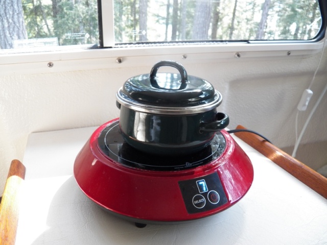

I bought one of these at Home Depot when it was $10 cheaper.
http://www.homedepot.com/p/Elite-Platinum-Portable-Induction-Cooktop-Burner-EIND-88/206192805
There is a picture in my photo album with it simply sitting on the standard CD 16 table.
I read on various sites that induction cookers don't work with inverters that aren't pure sine wave. I had an old 800W Coleman modified sine wave (MSW) inverter, never really used, and tried it with the induction burner. If anything, it worked better than 110V home power because the burner was a little too powerful for simmering rice and oatmeal or heating a can of chili. The "inefficiency" of the MSW inverter was just what I needed.
Having now spent several nights aboard, I'm really happy with the system. I usually use it only at anchor, but it is possible to place it on the passenger footwell (when solo) and cook when under way as that low spot is relatively neutral to the boat's motion.
My digital voltage meter shows a drop from 12.6V to 11.5V when it is consuming power, but it is about as fast as a microwave and heating dinner in a pot takes about 5 minutes. The battery then comes back to 12.5 or 12.6 when the burner and inverter are turned off. I used it to cook dinner, had the Espar heater on for a bit, used it to cook breakfast (and had the heater on in the morning), and only dropped my Group 24 house battery to 12.4V. I was afraid that it and the Espar might really suck electricity, but that doesn't seem to be the case and I generally run the burner for less than 10 minutes. I would need to run it longer for rice, but that would be at the lowest setting, so I don't think that will be a problem. And I could always idle the engine for a bit if it became a problem.
No open flames aboard. No flammable gas to leak. No extra moisture produced. No canisters of butane to buy or store. 110V power on board. Cook top stays cool to the touch. No burning of spills. Compact. I like.
I already had the inverter, so that wasn't an expense. I also don't know if every modified sine wave inverter would power an induction burner. And you have to use a magnetic pot, so one of these that works on an induction burner was an extra expense.
http://www1.macys.com/shop/product/primula-stainless-steel-6-cup-stovetop-espresso-maker?ID=500243&CategoryID=24732&tdp=cm_app~zundefined~xcm_zone~zPDP_ZONE_A~xcm_choiceId~z500243~xcm_pos~zPos1
How decadent is that?

Pictures are always nice. Here is a picture of Marco's induction burner:
But we are firmly in the butane burner camp. We have one on our RV, one at home, and one on the boat. Good to know about lubricating them, we have never done that and never had a problem, and we have been using them for 10+ years, but better safe than sorry. You should probably pay attention to Harry, the rocket scientist!
