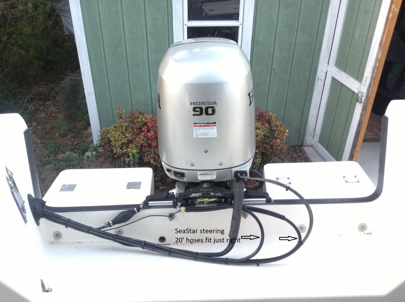

Here is a photo of my SeaStar ram in the splashwell.
http://www.c-brats.com/modules.php?set_albumName=album1847&id=photo5&op=modload&name=gallery&file=index&include=view_photo.php
My Rigid Hull Inflatable has the BayStar system. I'll take a photo and send it for comparison. The ram seal failed on this unit when I was off shore...I had to hand steer the 90 Honda to get home. I will be changing it to a SeaStar or a Ultraflex this spring, as I have repaired the ram and the helm more than 4 times.
Here is that photo (thanks!):
I would like to compare this to a Baystar, and I would like understand the difference about what moves and does not move with the two systems (apparently in one the ram moves differently than the other, and I believe for some related reason Les from EQ liked the Bay Star; I want to understand this, so I can make an informed decision for myself). I'm still open to either one at the moment, and also still not sure I completely understand the differences (which is why I started this thread).
Thanks to all for the input so far - and more is welcome.
