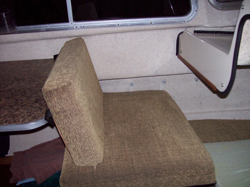

Here is one example of utilizing a cutout to make a forward-facing seat. It looks like support was provided for the seat back cushion when facing aft by making it a "stiff" cushion, like the dinette seat bottom cushions already are -- say with plywood under the Sunbrella.

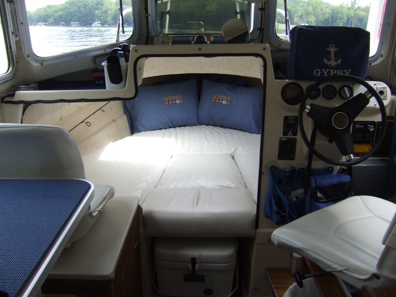

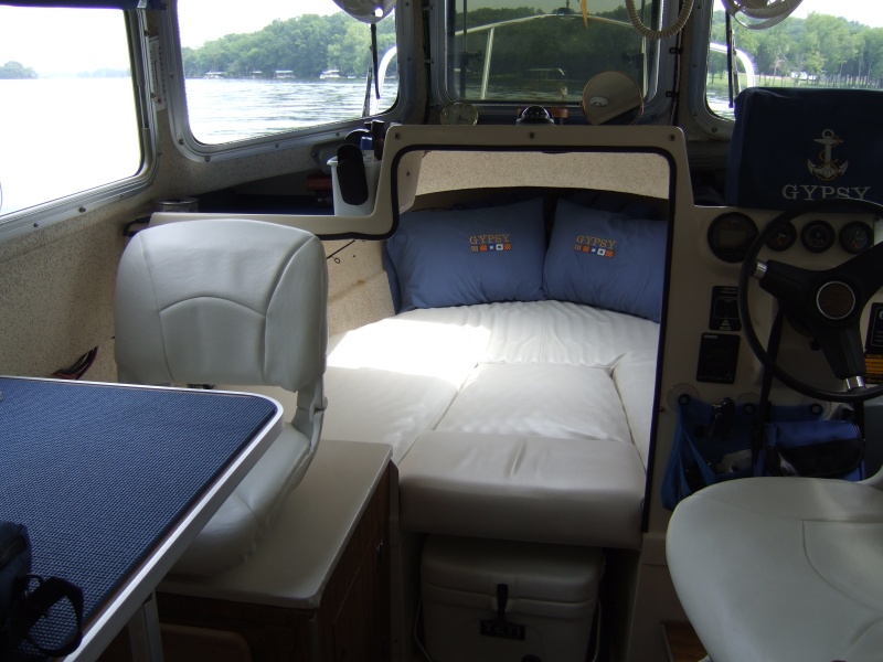

Here is Gypsy, with the cutout and a swivel seat (looks comfortable if you don't plan to use the dinette as a berth):
