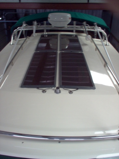

An old pic of the solar panels on Discovery. There are now 6 panels, for a total of 90 watts. Dedicated to the Norcold Refer. and a Waeco Freezer. Charges 3 group 27 wet cell batteries.
Brent
Brent and Dixie,
1984 22' Classic sold 2003
