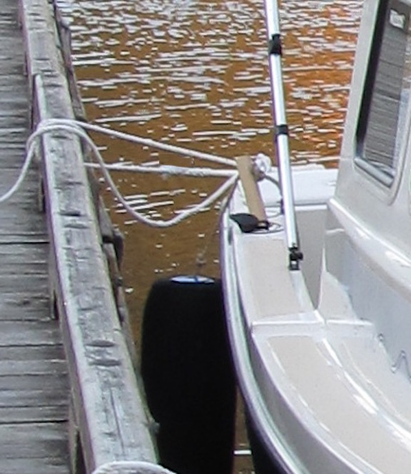

The C-dory's rear cleat is too far back and the bumper skids out behind the boat. I put a chrome door handle about a foot forward of my gas filler on the inside of my gunnel and clip my rear bumper on that.
I had a feeling that a fender secured to the after cleat might do that, so I also went with a way to hang the fender further forward. I got the idea from Will-C's album. Basically, the fender hangs from a dowel (ash tool handle or PVC) that is plugged into the rod holder (my boat happened to already have these mounted forward of the fuel fills). Side bonus is the height keeps the line from touching the gelcoat. I wrote a little more about it in the "Best idea under $20" thread that is currently being posted to.
