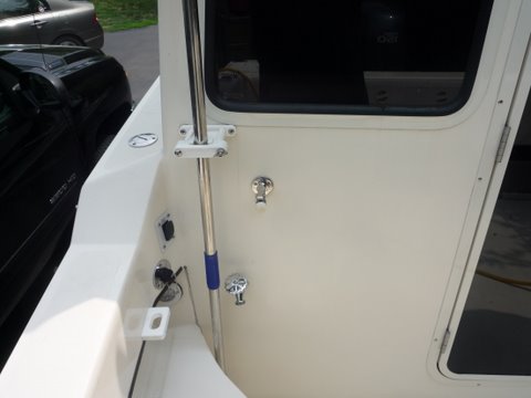

The fresh water spigot next to boat hook. Fresh water fill up on the walkway/gunnel. A raw water wash down has black cover and the raw water wash down switch is above it just to the right. We use a Flowjet 4405 pump for the fresh water system. We purchased it from Defender Marine their part number 500664 currently $117.99. Happy Days
