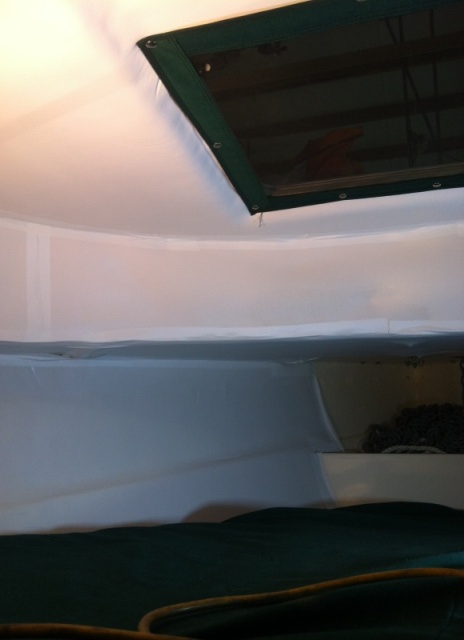

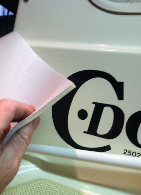

My wife and I insulated the Vberth with this product last winter and are very pleased with it after a years use. We plan to do the remainder of the cabin on our 22 this winter. It is available at Sailrite.com. To complete the Vberth took 6yds. of Item 769, "Headliner Foam Backed White 54 in." at $197.70. It took one can of aerosol adhesive Item 73211 "3M General Trim Adhesive" at $18.95. All seams were taped with white 3M Duct Tape from the local building supply. It took us about two hours to complete the Vberth. The product is fairly form fitting as you can see from the pictures. The liner is 1/4 in. thick so provides good insulation value.

That looks GREAT!
Does it help with condensation?

We have not had any moisture in the Vberth since installing. Here is the link for more detailed description and installation video:

After a couple of years we are still very pleased with the product. It looks great and has eliminated condensation in the vberth. There is no moisture or mold between the hull and the material. It adheres good to the fiberglass and has not separated anywhere.
My wife and I did the install in an afternoon and if I remember right the cost of the insulation and aerosol adhesive was $200. No regrets. Ken
