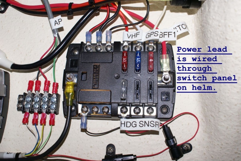

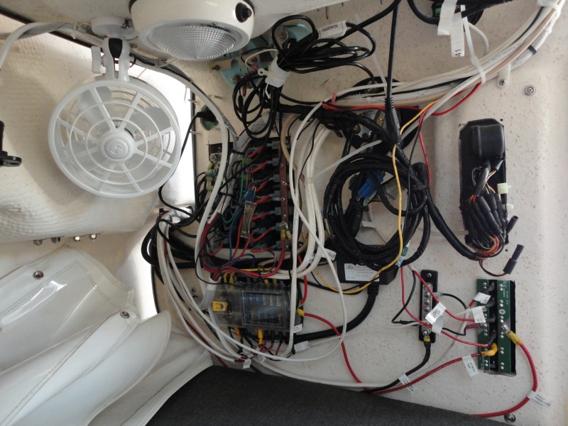

OK, here are six pictures. The Heading Sensor (along with the VHF and GPS) is wired through a fuse block, but the Sounder is not. Things are pretty much as I remembered them, with one puzzling exception which is discussed below and which I hope is just a labeling mistake by the installer.
1. THIS FIRST PHOTO IS JUST AN OVERVIEW OF THE SPAGHETTI:
2. THIS ONE SHOWS THE HEADING SENSOR WIRED TO THE MIDDLE TWO OF THE THREE POSITIVE AND THREE NEGATIVE TERMINALS ON THE TOP EDGE OF THE FUSE BLOCK. THE REMAINING TOP EDGE TERMINALS ARE OCCUPIED BY THE VHF AND GPS (but see the last picture regarding the labeling of these terminals):
3. THIS ONE SHOWS THE POSITIVE AND NEGATIVE BUSBAR CONNECTIONS FOR THE SOUNDER:
4. THIS ONE SHOWS THE INLINE FUSE FOR THE SOUNDER IN RELATION TO THE BUSBAR:
5. THIS ONE SHOWS THE SOUNDER INLINE FUSE AND THE BLACK BOX CONNECTION:
6. THIS ONE SHOWS THE INSTALLER'S LABELS ON THE FUSE BLOCK, BUT I DON'T BELIEVE THERE IS ANY CONNECTION HERE TO AN "FF" (I'M ASSUMING THAT "FF" IS MEANT TO STAND FOR "FISHFINDER" OR SOUNDER):
For starters, I'm thinking of just one switch. It could also control the VHF and GPS - even those these two don't have the "standby" issue. Would it make sense to get a bigger fuse box to make room for the Sounder wiring, and then move that wiring from the BusBar to the new fuse block along with the heading sensor, the VHF and the GPS? Would that simplify switch installation? Are there any issues with the Sounder inline fuse if I do this? I notice the Heading Sensor has a 1Amp inline fuse inches from a 2Amp fuse in the block. Is that necessary or advisable? What size additional fuse, if any, would I use in the block for the Sounder?
So . . . how would I go about installing a switch that would allow me to turn the Sounder and the Heading Sensor off while the battery is on?

I added a second fuse block, but with 12 connections. I got rid of the inline fuses--and put the same size fuse in the fuse block. That way there is no question if a fuse ever blows, where it is. This also gives every connection from the console area with its own fuse block. As I recollect, the wire went from the fuse block to the switch, and then to the appliance--GPSs, Radios
(I have two of each).
I suspect that the installer used the GPS/FF as generic: the GPS, and did not consider that the sounder module was powered directly, with its own in line fuse.
In your case, if you want one switch for the sensor, radio, sounder module and the GPS, then you would have only one fused circuit for those three, on the block--then to the switch for the three--then off to the electronics.
There is another way, and that is to put a switch into the main feed of that fuse block--and that block only has the sensor, radio, sounder module, and GPS. These fuse blocks are not easy to split--as some are--where the power to some fuse blocks are. The solution for your set up--would be to keep this fuse block for the electronics--and then add a second fuse block for the other items:
Hope that helps. In the C dory 22 there is plenty of room on the side for a second set of switches (Actually I believe I added two extra sets of switches.)
I did find this photo of the back of my console--but it was not completed yet. I have replaced the 6 fuse block with the 12 fuse block on the left, and then later put in the 6 fuse block in the "blank space" in the center. There a second set of switches in the right lower area--but I also add several more switches on the side of the console later. Note that I do label all of the wires. Later I did clean up the bundles a little more, and put on more ties:

[quote="thataway". . . I got rid of the inline fuses--and put the same size fuse in the fuse block. That way there is no question if a fuse ever blows, where it is. . . .
This makes perfect sense to me.
[quote="thataway" . . . I suspect that the installer used the GPS/FF as generic: the GPS, and did not consider that the sounder module was powered directly, with its own in line fuse.
The likely explanation. I'll just change the label.
[quote="thataway" . . . There is another way, and that is to put a switch into the main feed of that fuse block--and that block only has the sensor, radio, sounder module, and GPS. . . .
This sounds like the way to go for me. I'll just get another block and dedicate one of them to the electronics I want switched.

Well, I'm happy to report the new fuse block is in. It's dedicated exclusively to electronics. Everything works (phew!), and I can now have the house battery on to run the anchor light (or cabin lights, or stove, etc.) without having the unnecessary 0.5 - 0.6 amp drain from the "standby" status of the heading sensor and sounder.
I owe thanks to Forrest for his advice and for letting me crawl around in his boat to see how someone who knows what he's doing has done it.
