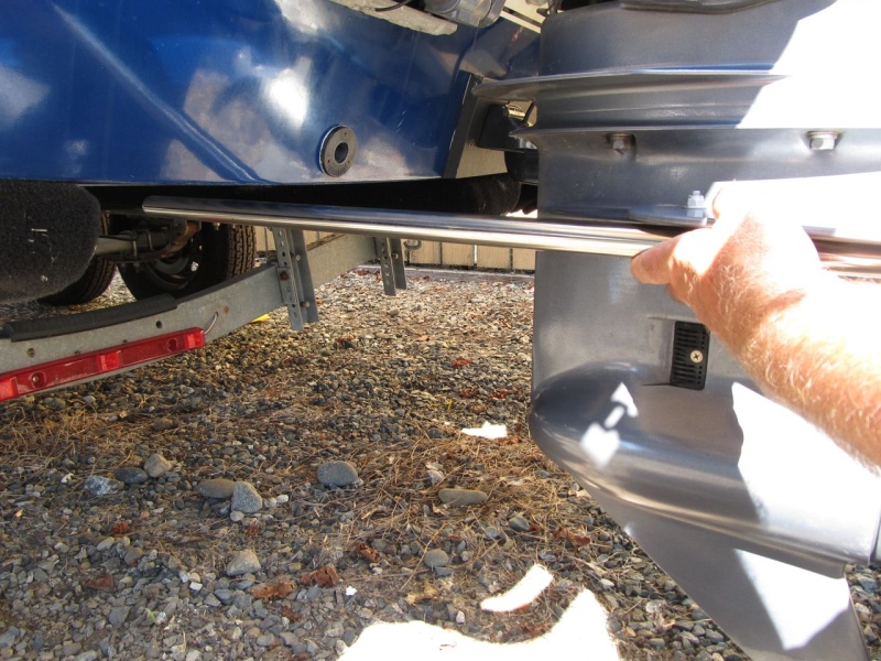

From what I have read in the archives, a first, "loose" check is to see if the bottom of the anti-ventilation plate is level with the bottom of the boat. Mine is an inch or so lower than that, I think (I wasn't sure exactly how to angle the engine vis-a-vis the bottom or the transom; I guess the gap would be smaller if I had raised the engine to make them more parallel). You can see it here:
I also read that a more precise way is to see that the Permatrim rides just at or under the surface of the water when up on plane. I tried to ascertain that yesterday, but there is a lot of turbulence back there when on plane (is this normal?) so it was hard to tell. Maybe it's easy to tell when it is at the proper height and can be seen? Or does one always sort of "extrapolate" through the spray?
If the engine is too low, I imagine that is the thing to correct first. On the other hand, I'm not sure I would do that before Powell, and so I still think maybe I would rather order a prop now that might help. If I later move the engine up, it seems it would still be useful to have a "gradient" of props for different loads/altitudes, and they can be spares as well. If I can get one ordered tomorrow, I should be able to receive it and put it on before Powell. I'm hoping to spend a few weeks there and don't like the thought of lugging my engine that whole time.

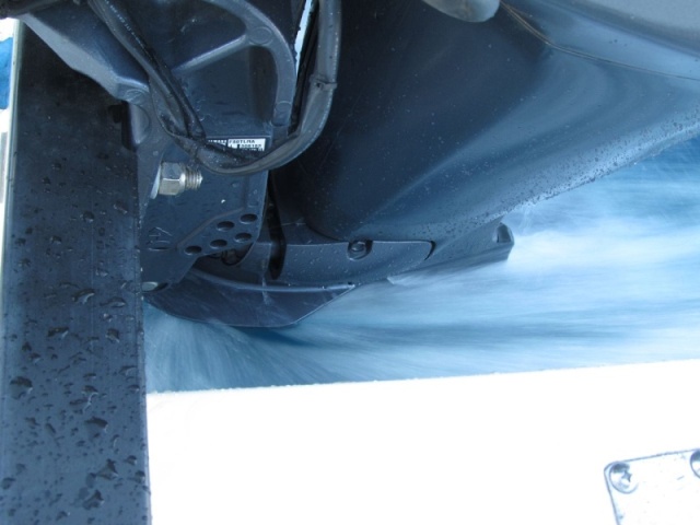

Lets look at things. If the engine is properly trimmed, the Permatrim should be just at the surface of the water--yours is well buried. So your motor needs to come up a little (was it the 300 lb person or the 100 lb person taking the photo?--that could make some difference.
I would have fiddled with the engine trim and the tab trim to find my fasted WOT--Generally with the permatrim on the engine, I have the tabs pretty well retracted. the 30% tabs sort of puzzles me. You look at boat speed, not where the wake is breaking. For WOT trim the tabs all of the way up, trim the engine about neutral--and then with the throttle full forward move the engine trim up and down slowly to see where you get the maximum speed of the boat--and that should also be the MAX RPM
Looking at the photo of measuring the level of the outboard--Have the cockpit floor or cabin floor level on the trailer, and then put a level on the Permatrim , and put the yard stick or what you are using on the bottom of the boat to establish a plane. The stick held against the bottom of the boat should show the Permatrim or top of cavitation/antiventillation plate should be at the same level as the bottom of the hull. Yours is not visible at all, showing that the motor is set a bit too low. I would take it up one hole and check again.
Who ever suggested the prop knew that you were going to load the boat--and suggested a lower pitch with 4 blades to give stern lift. Going from 3 blade to 4 blade may cost you from 100 to 300 RPM (depending of cupping etc.) So the 4 blade prop may be what you are going to get...but I am wondering about trim etc. and weight. Crescent Lake is about 500 feet so that should not make any different. My concern is that you have a lot of prop slip by calculation: 30% slip. The light boat was 18 slip--and that is a reasonable number. If your boat had gotten 30 mph light, the slip would have been about 12.5%, which is ideal. So maybe the motor being down a bit low, plus the drag of the permatrim in the water slowed the boat down.
(not saying the permatrim is bad, but it needs to be on the top of the water)
Okay, good to get your input and help reasoning it out. With all the spray and etc. at the transom, I wasn't sure what I was seeing as far as Permatrim height (or what I should be seeing). I was taking the photo and the "gorilla" Smile was at the helm.
That confirms my thoughts. It looks like I have room to easily take it up "two holes" in total (at about 3/4" per hole) just by using the sliding slot and without changing the holes in the boat. So there is some room for adjustment. I'm not sure if I will do this before Powell though.

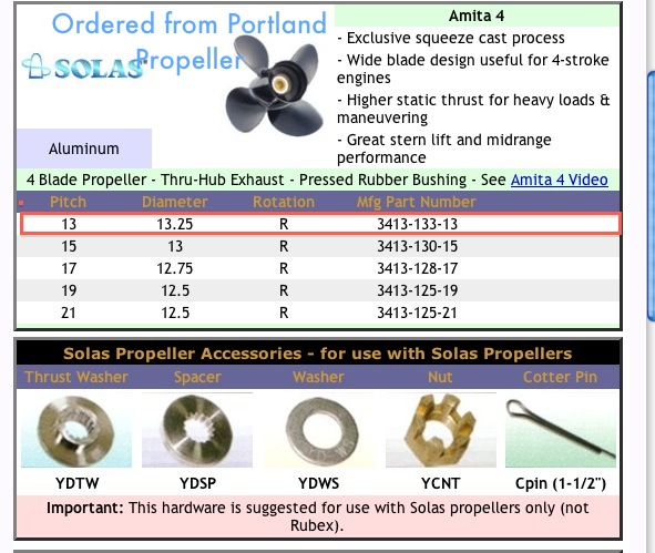

So here is one reason I'm confused. I searched "Powell" and "prop" and was happy to see a post by Kerri-On. Reason I say that is that there are two people living on the boat, so it must not be super light, and he has a Yamaha 90, which at least bears some resemblance to my 80 (although mine is really the equivalent of the 75 in current parlance). Here is what he had to say (and George, if you are reading, I'd be very interested to hear your thoughts):
ghone wrote:
Just picked up my Powell prop 13 1/4 by 15. Should get me the 500 rpm I lost with the 17 pitch. We shall see. George
So apparently Kerri-On had a 13.25 x 17 (we'll assume 3-bladed as I guess that's more usual). And then went to a 13.25 x 15 for Powell. But I now already have a 13.25 x 13 for "non Powell" which still has me in the lower RPM range at WOT. So is the difference that great with a 4-bladed vs. a 3-bladed? I'm not stuck on 4 blades, so I can switch to a 3-bladed if that's better. Or is the 10 hp that big a difference? Or am I hopelessly confused.... ?
The idea of spending a month on Powell either lugging or running along at displacement speeds (or higher speeds sucking excessive amounts of fuel) is a bit of a bummer. So my first priority is to figure out and order (tomorrow) whatever prop is most likely to work there. I'm not too crestfallen about "previous investment trap," so if it turns out the 4-bladed was just a mistake, I have no problem going back to a 3-bladed.
I think I maybe should have just started a Powell prop thread separately (?), but now I don't want to clutter things up on the board. And of course it's all related anyway.

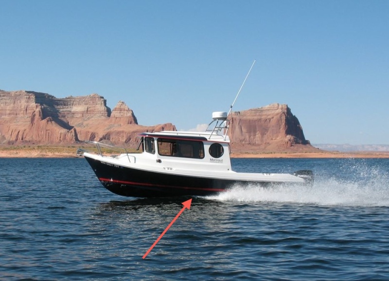

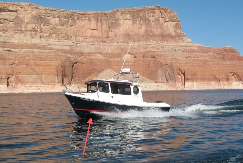

Regarding what I am describing as the "side wake" (which probably has a real term I just don't know yet Embarassed), here is a photo of what I meant, as shown on a Marinaut 21. I marked the forward point of the "side wake" (SW) with a red arrow. So in the first photo, the SW is further forward, and in the second photo, it's further aft. That boat had a fuel flow (consumption) meter, so along with to RPM and speed, it was pretty easy to see what was most efficient (and it felt best too). I found that it seemed to coincide with the SW moving aft (as shown in second photo), and it gave the best "magic carpet" feel, so I tried to use that as a guide yesterday on my boat. Would be interesting to have fuel flow meter.
I could get the "SW' on my boat yesterday partway back on the window (but still down by water surface), so quite a bit further back than the first photo; but not as far back as the second photo.

On both C-Dory's I have owned, the engines were mounted too low by the dealer by 1 1/2 to 2 inches. In both cases, I wish I had more upward adjustment but ran out of transom. I used Permatrims on both. On the 22 the Permatrim didn't seem to make a whole lot of difference other than cutting the top end speed by about 2 mph. Yes it helped get the bow down (or stern up), but its main impact was allowing a pretty efficient cruise speed at 12-14 mph. With the Permatrim off that cruise point move up a couple mph which is a lot rougher in a 22. On my 25 the Permatrim was a real asset as that boat is just plain stern heavy and it made a lot of difference in trim. In both cases I could never get the motor high enough to get the Permatrim up to the surface as far as it should be. In your case, with the Permatrim buried, it represents more drag than anything else. Moving it up will reduce the drag both from the lower unit of the motor and the Permatrim.
Interesting -- seems like there might be a lot of that going around Wink
I remembered that Roy/C-Way (who has my same engine rigged by same dealer) had raised his engine, and we had some discussion, but I didn't remember ever conclusively digesting the info as it compared to my engine. Well, I just now looked back through my PM's to where he had sent me back a specific measurement. From that I can tell that my engine now is at the same place as his was originally (which was too low). He moved his up to the limit (that is, without changing the holes in the transom), which raised the engine around 1-1/2" higher than it was, and with a heavy cruising load it sounded like his Permatrim was still not "floating" on the surface. That makes me think that even more lightly loaded there would still not be a problem of it being too high (and since no holes are being changed it could always be lowered). Since it sure sounds like it's a lot less fruitful to be playing with props while dragging the AV plate (with large Permatrim) through the water, I think I will try to raise my engine. Not sure if I will get it done before Powell, but I will take at look at it (and at my tools/resources) tomorrow. I may still order another prop for Powell just to have it as an option - not sure yet.

I run a 13 1/2 X 15 three blade all the time. It is the sweet spot where I get good performance at all elevations and loadings. I loose about 200 rpm at Powell but it really doesn't hurt because I'm still turning 5400-5600. It's important to let these motors turn up. I think the goal should be to prop so that you are turning the high side of your rpm range at sea level while light. Then when you go to altitude or load you will loose a little rpm but still be in an acceptable range...until you go extreme load or altitude. The dealer propped my boat with a 17 which I knew would not work once I loaded the boat. Dealers do that because they are dealing with boats that are new and light.
Your motor mount looks OK to me...looks real close to where mine is. Being a little low is definetly preferable to too high.
You absolutely should have a spare prop at Powell. File and a hammer a good idea also. Those rocks can be sneaky!
