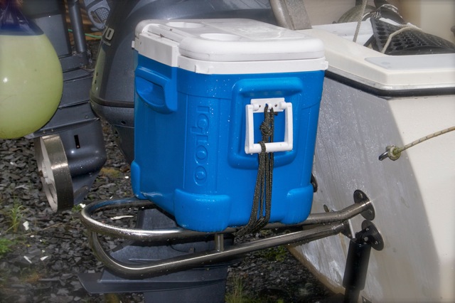

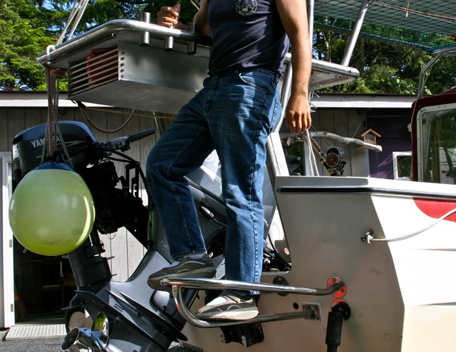

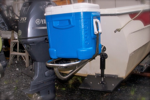

Ug, just catching up with the Brats... sorry I have been swamped... A summer project this year 2013. Best thing ever done to the transom since the electric tabs!

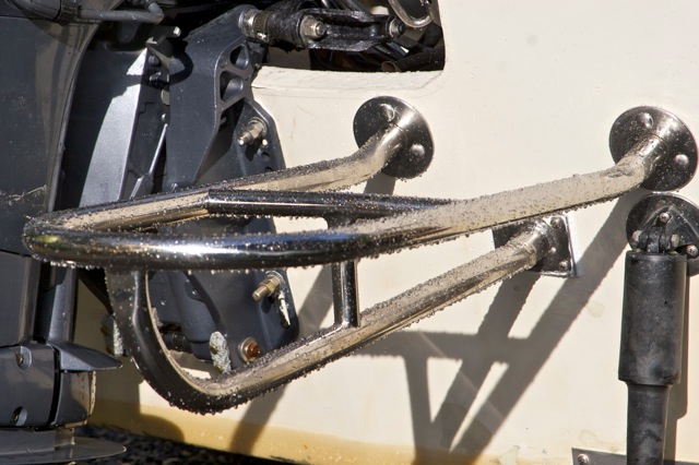

Just cob'd it together from salvaged junk Mad with the TIG, but happy as hell with the toughness and KOOLness of the thing this year. Xmas LOL
Gets that extra cooler out of the way! Idea
With the new 70, ranging from moderate to heavy between fuelings and fish on 5 day trips, I go ashore in some tough spots, the extra grab and step area now is just fabulous Love
A no brainer, what tarnation took me so long! Disgust

One thing i forgot to mention. I took off the platform-style swim step that came on the Fox because it always slapped the water too much and really was too small to feel safe about puting anything important on it. I am often stern-to the breeze (in reverse on the kicker) trying to hover bottom fishing these days, rather than anchor in waters way too deep or wavy. Anyway, the pipe design is what I wanted to have the style, functionality, and quietness.

I'm going to be the oddball here and express concern that wonderful craftsmanship aside, using the transom step as shown in the picture could cause severe bodily injury. If your foot slips, your leg could slip through and it will either get stuck, or suffer a severe break. If this happened when you were alone, it could be very problematic and possibly life threatening. The solution, I would think, is to attach a flat plate with anti-skid properties across the top step supports. And if you are going to do that, attaching a fold down ladder would not be a bad idea, either. If you have ever fallen overboard, which I have done, it is very difficult to get back into a boat without a ladder. It would be hard even for a much younger man than me in frigid Alaskan waters.

To minimize the slapping but avoid the slip you could always find some tough black cargo netting or fish netting to wrap and tie tightly around the top section to make a mini cot like "platform", add traction, and still keep the slaps from happening. Plus your fingers could still go through it to grab the bar and it might even be a bit easier to hold onto with some net friction. I like my F70 too.

Greg got me thinking -- you could attach a steel grid across the top. If properly designed, it would support your weight, provide traction, and prevent slapping.

Me thinks this looks like a hole to (mis)step into - a trap rather than an aid.

Yep, right yuz arz Very Happy I'd prefer a thick nylon mesh over a metal one so far. I had imagined being in the water, this pipe is about the best thing for your fingers to latch on to. It's easy to grow the thing with more features, being thick walled SS tube.
