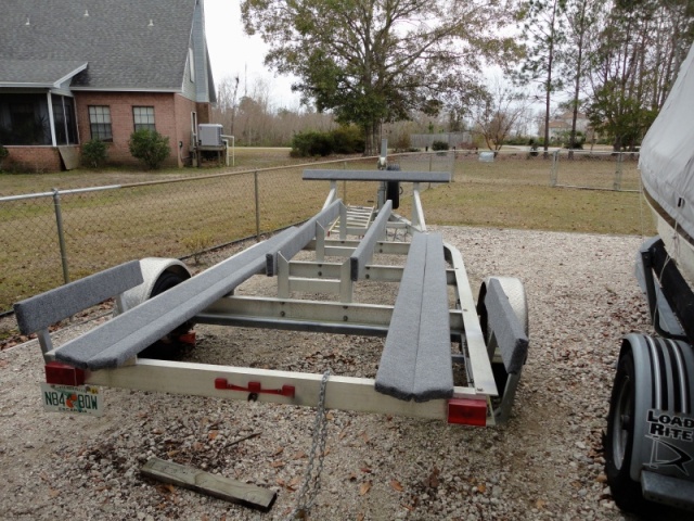

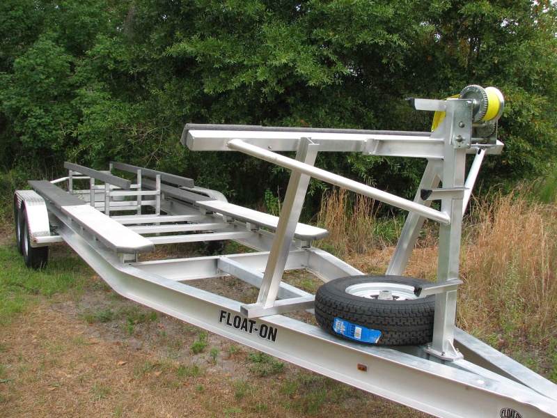

Tom Cat 225 trailer;
Caracal 18 trailer:
These are similar trailers, but there is more bracing than on the Tom Cat 24 trailer down the street.

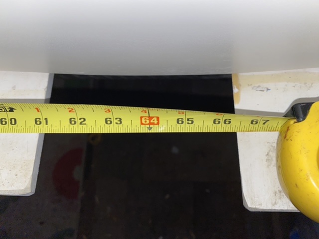

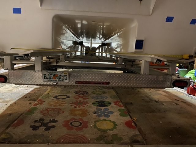

After many years of trailer troubles we built a custom 12K lbs trailer and never looked back. So far it has been flawless. I measure 64" center to center spoons at the rear of the boat. The front hull has some confounding angles so that is where I would pay particular attention.
